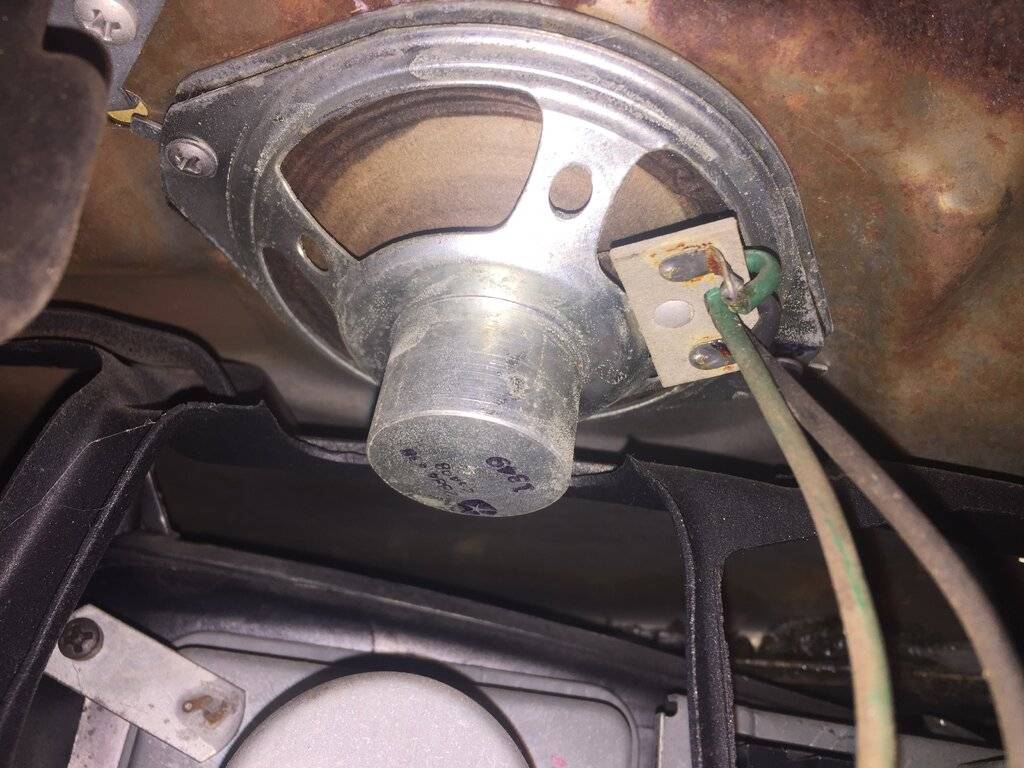

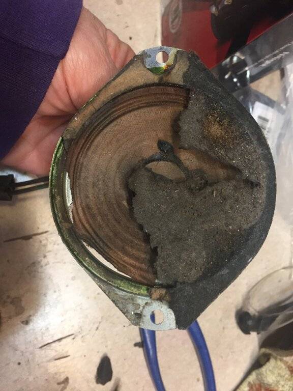

I just happened to have a non-ac 69 Fury dash out and took these pics. I would think these would be called 3.5" round but the actual dimensions are 3 3/8" dia, 1 1/2" depth, mounting holes 4" apart. Looks like the cone has a part number on it. Might be 3505-31. Its hard to read. Maybe -311 A normal magnet 3.5 wont fit without cutting the gauge mount that is in the pic. But that's for Fury so Polara may have different config.
