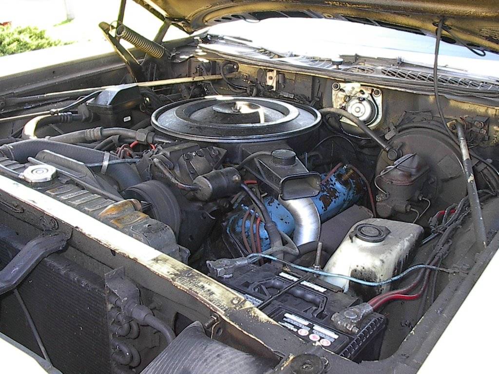

New owner of a 1973 Newport Custom. Right now it's off the road, but very close to being road worthy.
To do-
Sitting since 2006. Tank seems empty, but need to inspect.
Question: Is that worthy of pulling the tank, cleaning & sloshing, or pop in a gallon & flush it to see what comes out OK?
Need to do a brake job. Has a sticky caliper anyways & who knows how old they are in general.
Also may need to pull the transmission to correct a fluid leak from the torque converter area.
As it is the 2 barrel 400, I was also considering changing that to a 4 barrel if it would provide gains short of doing a cam as well?
This is a car that was babied by the original owner. It's completely original & apart from some very minor spots is rust free - a miracle when it comes to salted winter roads here, so I'm seeking to keep it as original as I can.
Also- I notice in the service manual a fair number of 'special tools' needed to work on them. How many of these actually are or can be substituted? Any I should just buy now?
I've helped restore two cars in the past with my Dad, a 1953 MG TD and a 1962 MG-B, but these are very different things.
Any advice from those who've done this - Would love to hear your thoughts now as to, "Gee, I WISH I did that when..." Hindsight is 20/20, so hopefully I'll grab a bit of the future..:)
Pull the fuel tank, there will be some garbage in there if it's been sitting for 13 years.
Pull all the wheels and look at each brake, you may need to change all the hydraulic components , master cylinder, calipers, hoses, etc.
Only a few things really need special tools. I would get them or borrow as required.
Do not run the car with stale gas!!.
If you really want to get her running use a gas can and hook it up to the fuel pump with some rubber fuel line.
As mentioned,drop the tank and get it cleaned out.
Replace fuel filter and fuel pump. (Trust me on the pump,it will save you headaches later on)
The Holley 2bbl on the 400 are junk,so I agree going with either a stock iron intake or an aluminum Edelbrock 383 Performer intake. (400 is a low deck B engine so it will fit).
Carb you can do a 650 Edelbrock with stock cam or 750 with mild cam.
Compression was way down in 73 so you do not want to go crazy on the cam choice .
A big cam you will not gain anything. There is a risk of losing compression during overlap.
An RV grind from Summit or Comp Cams will wake her up.
Since you are thinking cam may as well get rid of the nylon gears on the timing chain and go with a Cloyes double roller. Yeah overkill but super reliable and many happy miles of motoring.
For ignition stick with the stock electronic system but with today's corn fed gas do a recurve on the distributor or get one from Summit.
They have a really good curve in them and the big Chrysler will respond very well to that.
I agree that the entire brake system should be gone through.
73 was known to be the most desirable braking system.
Good news the 73 brake parts are still very common and affordable.
New calipers,wheel cylinders,master cylinder,pads and shoes,combi kit and brake hoses.
Do not skimp on the brakes!!
If the seal at the transmission front pump is leaking,the trans has to come out. May as well go through the trans while you are there.
Unless you are rebuilding the trans yourself,or doing the seal that Big John mentioned,there are no real special tools needed to revive your Newport.
Just common sense and better judgement..lol
If sitting that long,and from my experience,knock out the freeze plugs and flush put the block. B/RB are known to build up sludge at the bottom of the block's water jackets (below the freeze plug area) when sitting for a long long time. That can cause an overheating issue..been there done that.
Any rubber related parts must be checked--vacuum hoses,suspension parts,etc.
Electrical system..
Remove bulkhead and clean all connections and use dialectric grease.
Bypass the ammeter gauge before it gives you fits (and it will--give it time).
Check and clean ALL grounds under the hood and all lights.
Congrats and good luck!
PM if you have any questions
Cheers
