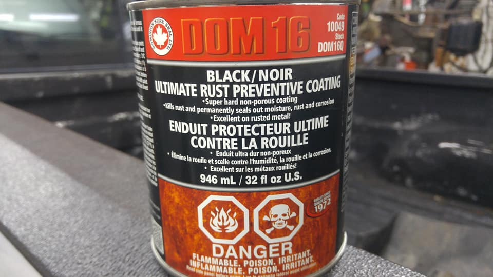

CBODY67
1/3rd the cost of POR, and made here in my home land of Canuck....
