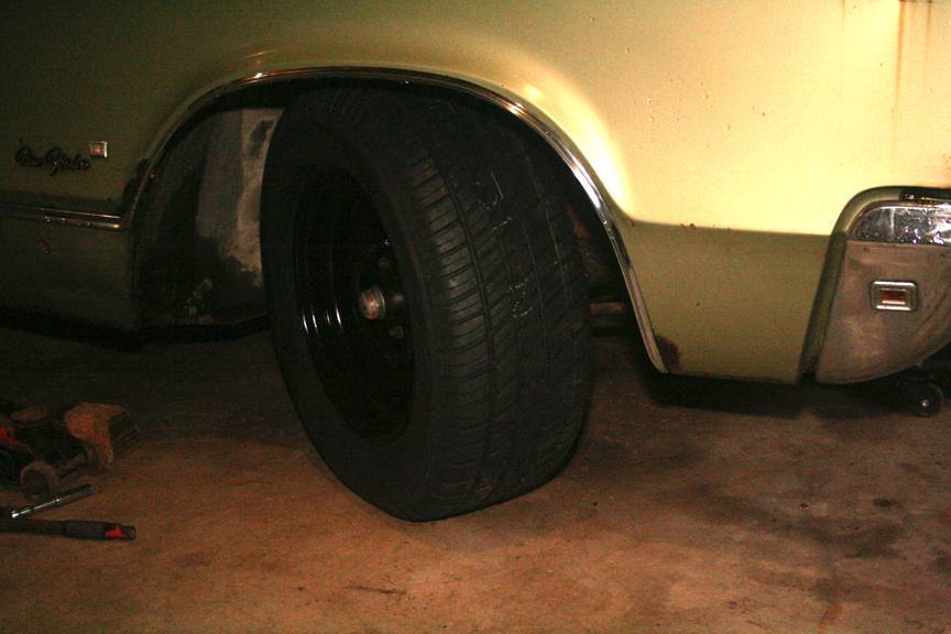

On my 68 NYer I've got 15x7 steel wheels, I'm not sure of the backspacing. I've got 255/60R15 cooper Cobra's on them. According to Cooper's website they are just over 27" tall. Even with the extra width they turn lock to lock up front and there is plenty room in the back.

Your tire size is acceptable,but a bit small in diameter.However,they will give the car a nicer ride and lower the center of gravity. Wider rubber will always give a slab a smoooooth ride!
If she has 2.76 gears,the smaller tire will work like 3.0ish ratio.
You may have already noticed a little more pick up from the line,yet the speedo will read faster than what a GPS will read,and the engine will rev a few hundred RPM's higher on the freeways.
Nothing wrong with any of that,just an occupational hazard since I work in a tire shop,LOL!!
