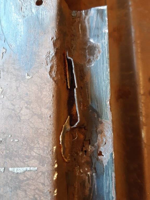

Hello everyone,
After removing the rear window of my '70 Sport Fury, I noted 2 types of clips. The first one are the trim clip, but I do not know the use of the other (in the photo below).
Can someone tell me ?
Thnak you.

There were only two on my 69 Monaco, one left and one right. As for replacements, I have no answer. They are spot welded on. The windshield, on the other hand, used a rubber shim/spacer under the glass to set the height.
