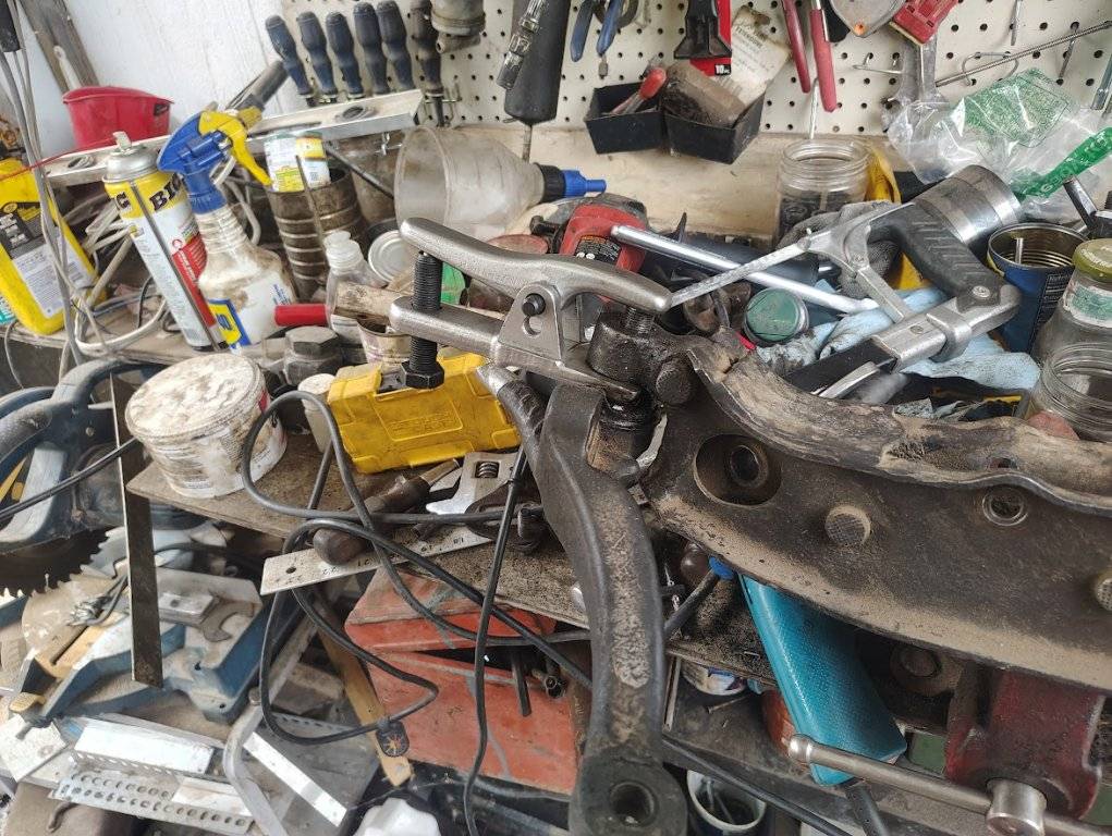

So, having all the parts this time, and a much improved panoply of tools, I commence with preparing the left LCA, both upper control arms and the sway bar before I park Gertrude for the surgery. I have ONE putative ball joint separator obtained from AutoZone, which I'm now attempting to press the ball joint stud out with, as can be seen here:
Left LCA w "OEM" brand ball joint separator at moderate torque and pressure.

what you're showing in your pic should work just fine...if you've tightened it with as much muscle as you have available (with an 18 inch breaker bar) and it still hasn't popped off, give the side of the spindle where the stud goes through a helluva smack with the biggest hammer you have...the extra shock will help to pop the taper apart...most of the time we got those apart with just the hammer, but I was a lot younger, stronger and had better aim then ...the usual "pickle fork" and BFH works too but the rubber dust boot will be destroyed so I hate them
Better yet, take the next biggest hammer you have and hold it against the other side while you hit it.
The idea is that the hammer blow distorts the tapered hole for an instant, just long enough to make it pop.
For me it's the pitman arm (removal from steering gear) that is the worst. These other joints are normally pretty easy. If supporting the LCA and whacking the ball joint shaft with a 5 lb hammer isin't an option, then wrench down your tool and take out a camping or plumbing torch and heat the outer ring on the LCA. It will pop after 30 seconds max.

....plumbing torch and heat the outer ring on the LCA. It will pop after 30 seconds max.
You NAILED IT HOSS! 30 seconds and POP! Clunk, it came out right nice.
NOW We know, the BEST TOOL for this job is the BernZomatic propane torch!!!

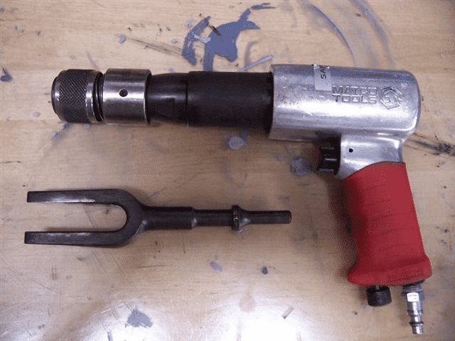

Amateur's... Air Hammer & Picklefork works like a charm on the stubborn ones.
I DID THINK of this option, but this is really just the B*FH of BFHs basically. Since an air hammer is less exorbitant than a pair of brand new tube type lower control arms, it merits some consideration I reckon.
*Biggest
