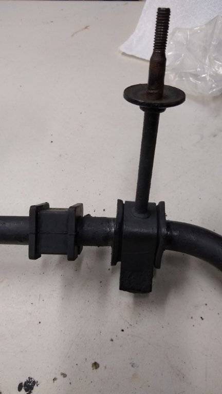

    I decided to change these out along with the front shocks.

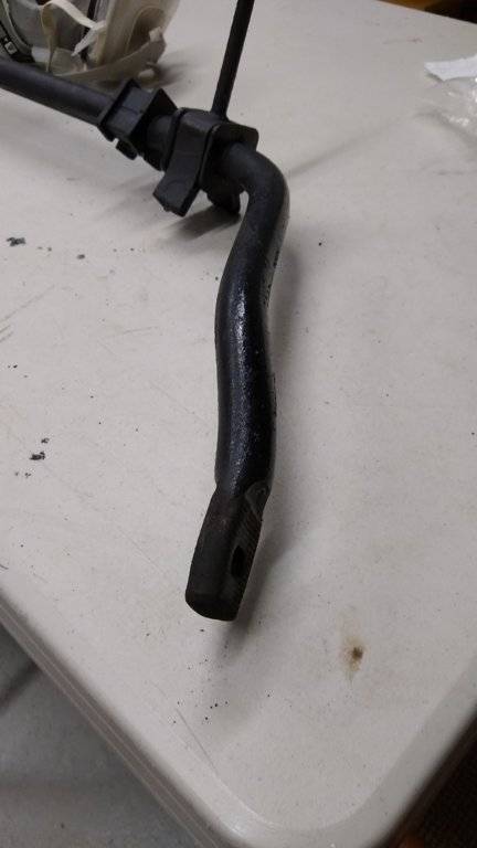

    I took out the bar and stood over it for a while. How the hell do I change these out? I have the shop manual and naturally it gives the example of the Satellite style bushings which have 2 piece clamps.
    There is no way to squeeze these out over the pressed end. I was thinking to cut them out with a razor, soap up the new ones and wrestle with them and a six of beer.... anyone have a better method?

    Drill the spot weld on the bottom and the C shaped section. Split with a chisel and bolt back together.

    As mentioned above, cutting and replacing with bolt on clamps is the only way. However, if they are not cracked or falling apart just leave them in. Mine were still flexible and in good shape, so I just cleaned the sway bar up and reinstalled.

    The upper ones were shot, so they're getting replaced, as are the strut rod bushings. I'll reinspect the square ones, if they're dry rotted, they're going.

    +1 hacked apart and ran a bolt thru it later. sucks.

    I just tore one of them apart... for a lousy $50, I'm buying a set of links from RareParts. I just don't have the tools or shop to do this the other way.
