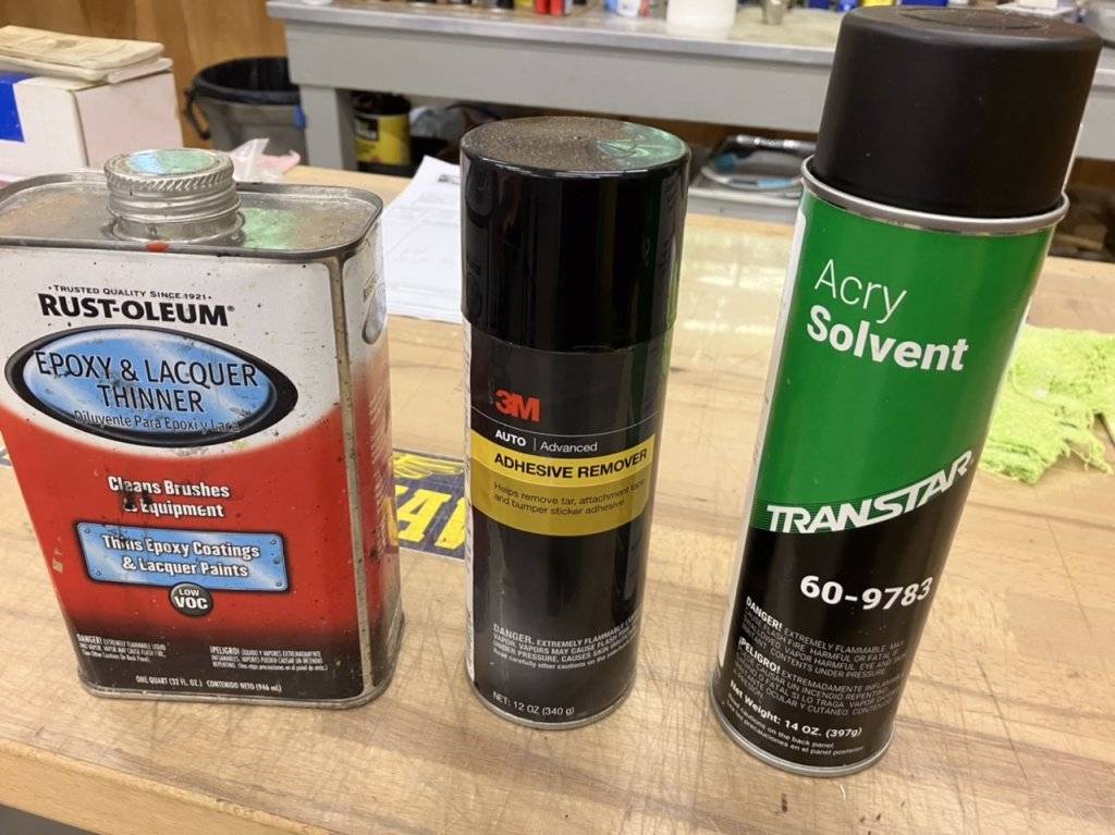

Some cleaner wax or other mild abrasive polish. Emphasis on MILD, if the polish.
The oils in the car wax can soften the residues and might even liquify them, just like it will do for "road tar" and similar.
Keep us posted on your progress,
CBODY67
I had the same issue but cannot recall exactly what I used. I suspect it was one these three solvents. It worked well whichever one it was.
