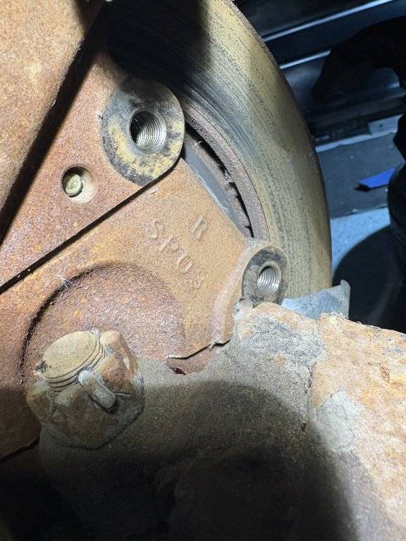

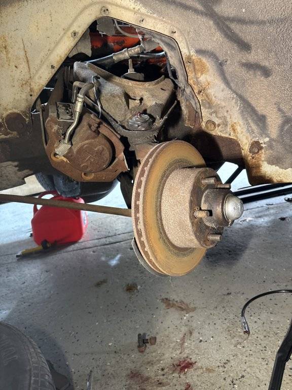

Doing a preliminary brake check on my fury vip.
Can’t seem to find this conversion kit online, would like to know if anyone can find out or if they have one.
The car is new to me and it would be good to know what parts I have, to be able to replace in the future.
Looks like a single-piston caliper. Which could mean a 1972 or 1973 OEM front brake swap.
What about the master cyl and booster?
Might need to find a website which details the size and shape of the brake pad backing plates. That can yield an "industry number" for the brake pads, which can further define the possible model years and applications. Might do similar with the size of the caliper pistons.
Just some thoughts,
CBODY67
Just some thoughts,
CBODY67

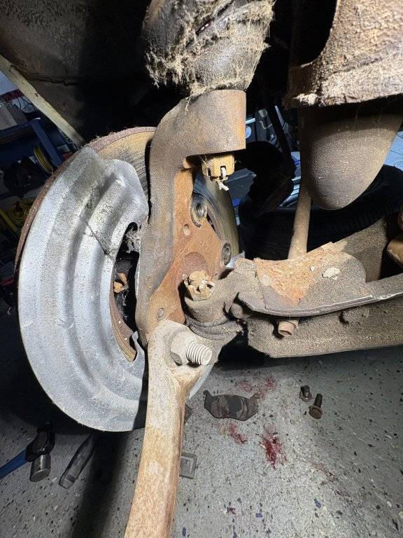

I thought the rest of my photos went up with the post, here are a few more.
Caliper.
CHRYSLERCORDOBA1980-1983
CHRYSLERFIFTH AVENUE1983-1989
CHRYSLERIMPERIAL1981-1983
CHRYSLERLEBARON1980-1981
CHRYSLERNEW YORKER1982
CHRYSLERTOWN & COUNTRY1980-1986
DODGEASPEN1980
DODGEDIPLOMAT1980-1989
DODGEMIRADA1980-1983
PLYMOUTHGRAN FURY1982-1989
PLYMOUTHVOLARE1980
11-inch Rotor and pad.
CHRYSLERCORDOBA1975-1983
CHRYSLERLEBARON1977-1981
CHRYSLERTOWN & COUNTRY1977-1981
CHRYSLERVALIANT1975-1983
DODGEASPEN1976-1980
DODGEB15001995-1996
DODGECHALLENGER1973-1974
DODGECHARGER1973-1976
DODGECORONET1973-1976
DODGEDART1973-1982
DODGEDIPLOMAT1977-1989
PLYMOUTHBARRACUDA1973-1974
PLYMOUTHCUDA1973-1974
PLYMOUTHDUSTER1973-1976
PLYMOUTHFURY1975-1976
PLYMOUTHROADRUNNER1973-1975
PLYMOUTHSATELLITE1973-1974
PLYMOUTHSCAMP1973-1976
PLYMOUTHVALIANT1973-1976
PLYMOUTHVOLARE1976-1980
Courtesy of ROCK AUTO.
I suspect they will be happy to sell you some new cheap Chinese ones.
