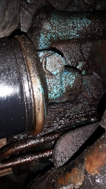

    Its the gasket between the engine block, and the part that the filter screws into. My engine is starting to drip oil from all directions. :mad:
    Best picture I could do, its in an odd spot.

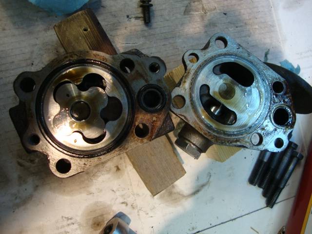

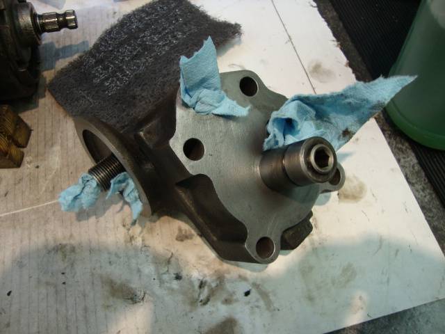

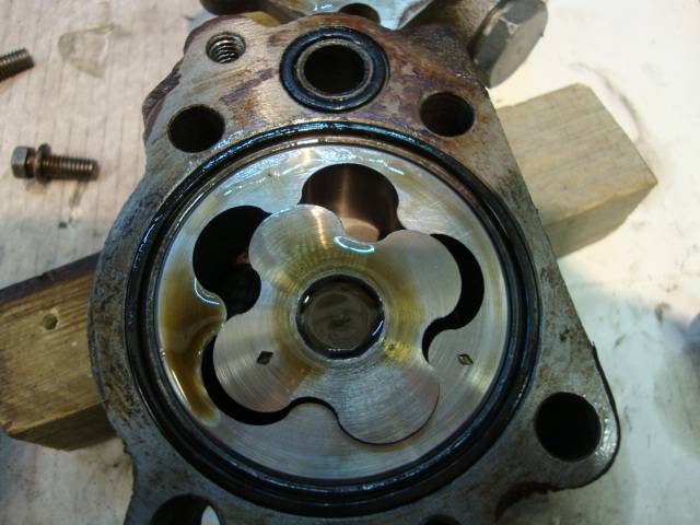

    Here is one that I pulled off my 440...a factory service manual does wonders
    • Thanks! Thanks! x 1

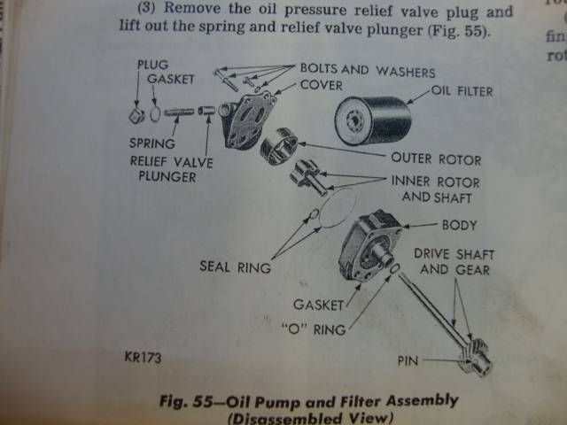

    Looking at your picture it looks like you may have the wrong oil filter, the oil filter should be larger them the pump body, just look a HWYCRZR's picture in post #5
    The only gasket between the filter and the pump is the one attached to the filter.
    Alan

    Thanks for pointing that out, filter was already on the car when I got it. Never noticed. The filter isn't where it is leaking though.

    Clean it first to make sure that is where it is leaking. If you are taking it all the way apart Make sure you get the gasket and o-ring on the block side and the two sealing o-rings on the pump cap and if your releaf is leaking the sealing ring on that as shown in @MrMoparCHP post above.
    A field service manual would have the correct procedure and the bolt torques for when you put it back together.
    It is an amazing book.
