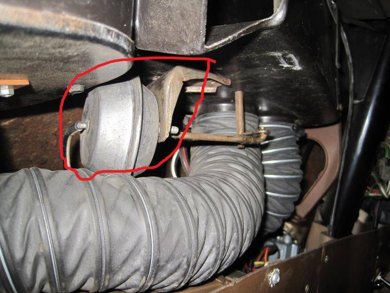

I think I know what it is. I believe it is a vacuum device that control the air flow from the defrost to your feet, am I correct? It lost its 3 mounting screws and was dangling below my dash.

Vacuum actuator. Probably open and closes a blend door. That needs to be mounted properly.
The bad news is you're likely going to have to remove 3/4ths of the dash to reinstall it.

It will actually be easy, I could see where the screws go and I think I can even do it with a regular size screwdriver. Right now it is really easy because the rest of the interior is out.

Before reattaching the vacuum thing, make sure the door moves freely. Had a similar situation with my Dart, the door was sticking sometimes, and when activated the vacuum actuator snapped the plastic bracket it was mounted to!
