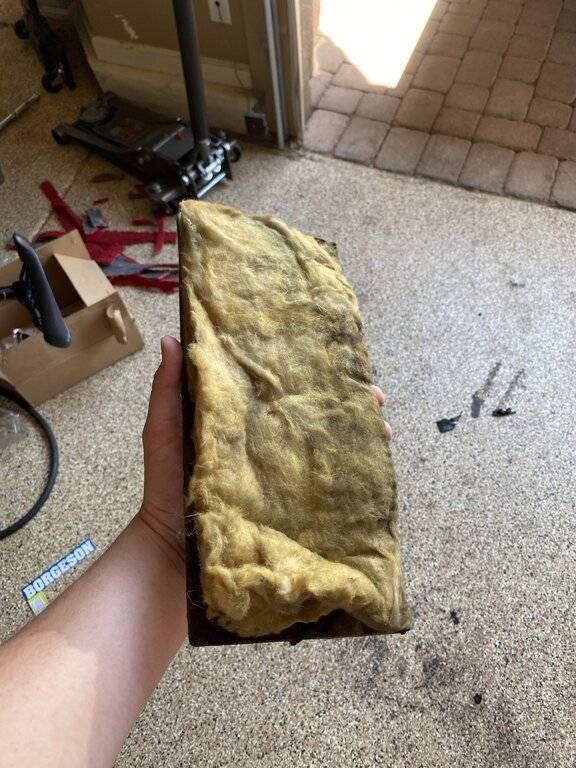

I don’t really understand what this piece is, a filter for the vent? It’s behind the panel that would be next to your calves if driving. Looks far too nasty to go back in if it’s a filter. Is it just sort of an insulation or spacer so I could put it back in with this condition? Are there repops of it? Trying to get the carpet done and can’t put that panel back in til I know what this is. Thanks
That is an insulation panel, mostly to reduce road noise. It is not a filter, so if it does not smell bad, you could reuse it. Could also remove the old fiberglass and cut a new piece and glue it to the panel..

Thanks!
