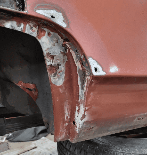

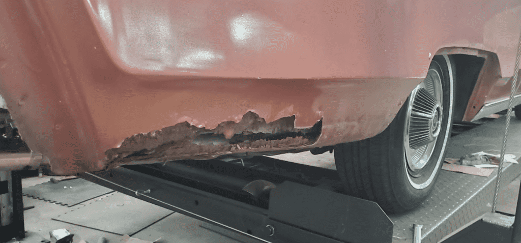

So the 300 had bad rear fender and trunk rust. What made it even worse is that in the past it had been half-*** repaired. On the outside facing surfaces, someone just put sheet metal over top the rust and "leveled" it all out with massive amounts of body filler. Some spots around the wheel arch looked like they had been brazed. The trunk extensions had some kind of stuff, maybe body filler, on them to cover the rust up. The holes in wheel wells were not even touched, just left open to allow in dirt and water. Holes in the trunk were covered with aluminum flashing that was pop-riveted. There was some **** slathered all over the rusty areas that I think may've just been grease because it would just come off onto your hands. There was even a rag saturated with that crap shoved into the rear-most crevice of the rear fender.
While some of that greasy stuff may've slowed down the decay, it and the shoddy body work have been making the repair job harder then if it was just let go since it all has to be cleaned up.

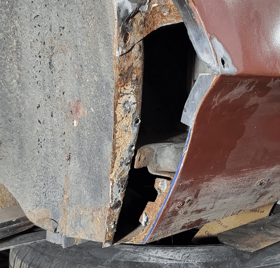

Here's what the fender looked like after I peeled away the bubbles of paint and body filler. That whole section was just flopping in the breeze.

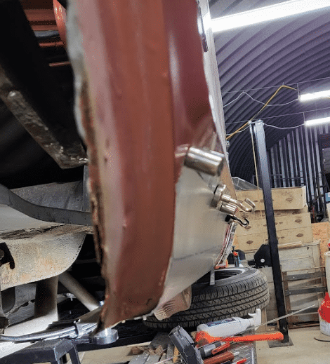

A view from the underside
A gnarly mess. The pin that fits into the fender skirt had threads :rolleyes:

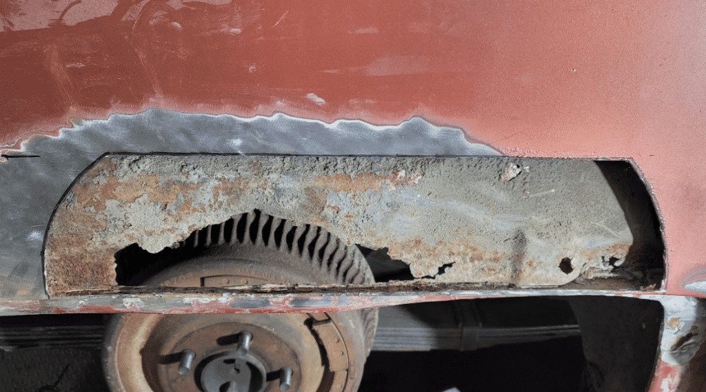

I cut away the whole lower fender except for the very end to serve as a guide. You can see inside the wheel well where I had already repaired the rear lip. That spot as well as the corresponding curve inside the trunk were rusted out.

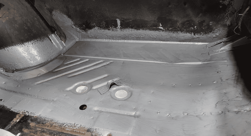

A view from the outside into the trunk. I removed that entire outer piece of the trunk floor. I had already patched the center piece in this pic. I didn't have a bead roller then (but I do now!)
Inside and outside of fender cut away. That inner section was a real big pain to repair as the shape was so convoluted. A pro probably could've made the patch out of 1 or 2 pieces of metal but I had to use 4.

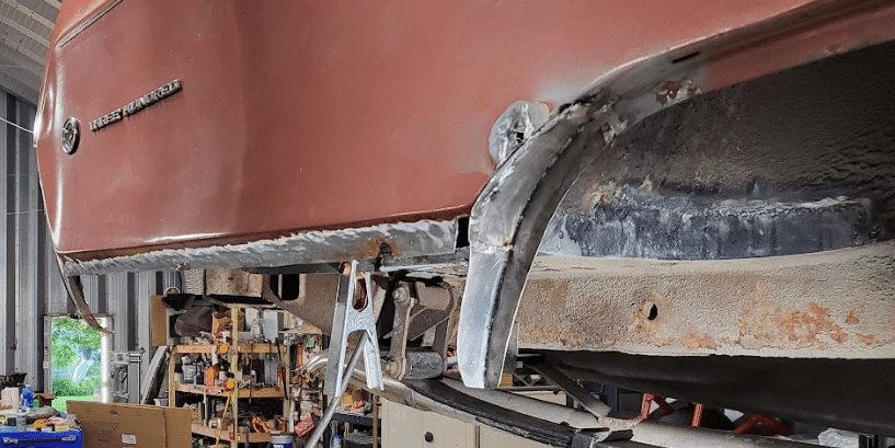

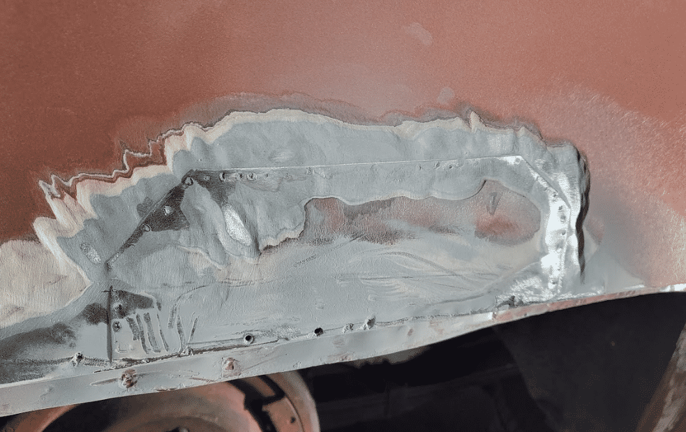

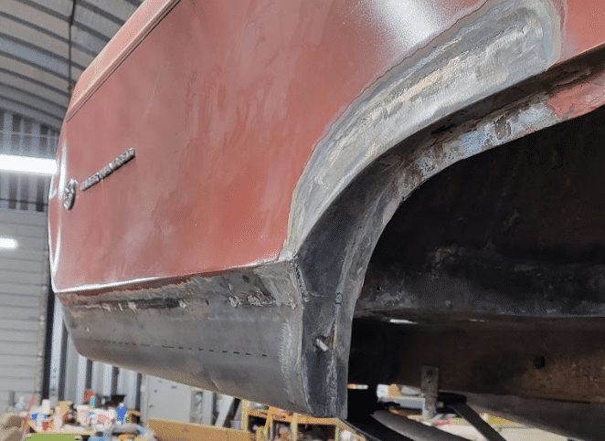

Test fitting in the rear fender piece
This piece was too wide to fit into the slip roller on my 3-in-1 so I bought an English wheel, I'd been wanting one so it was the perfect excus..er opportunity. I used a rubber band on the anvil wheel so it would only curve the metal in 1 axis. I learned that technique by watching Make It Kustom on YouTube. In fact, I've learned a lot from that guy and recommend his videos on sheet metal forming and welding to anyone who's a newb like me.
It's not perfect but it came out pretty good
I used a C2C patch panel to repair the trunk floor and fender drop. As many of you probably know, their patch panels are not plug and play and it had to be augmented with additional pieces. In retrospect it may've been easier to just make the pieces myself.
Made a new brace piece. The paint is KBS rustseal

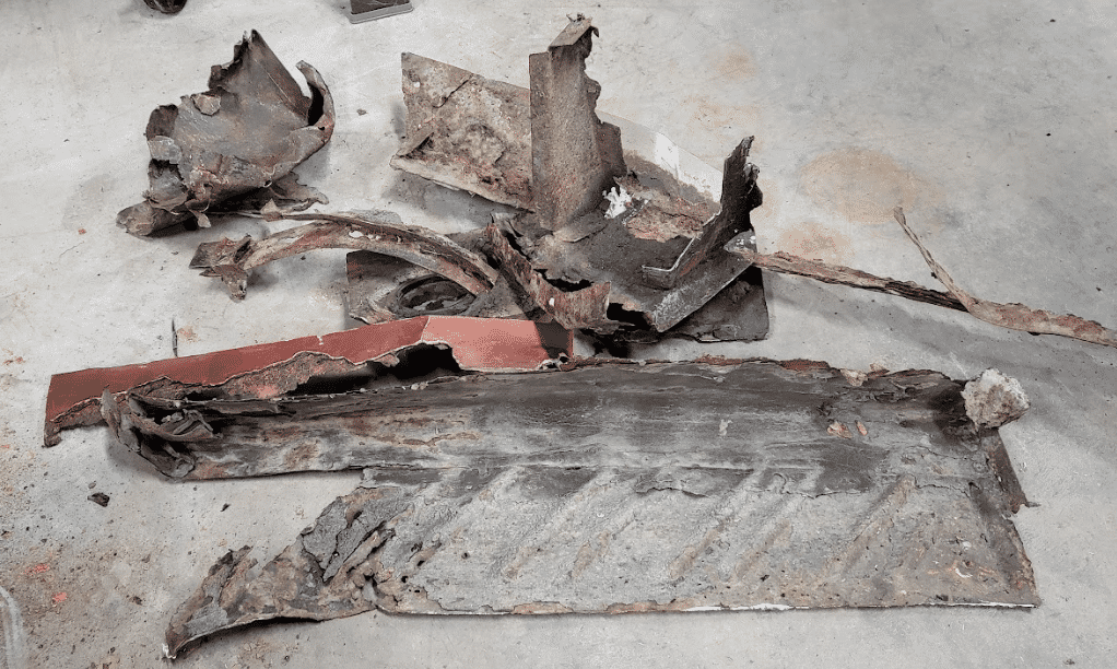

I've been keeping all the rusty pieces I cut away so when I'm done I can look back at everything and feel good. ewww

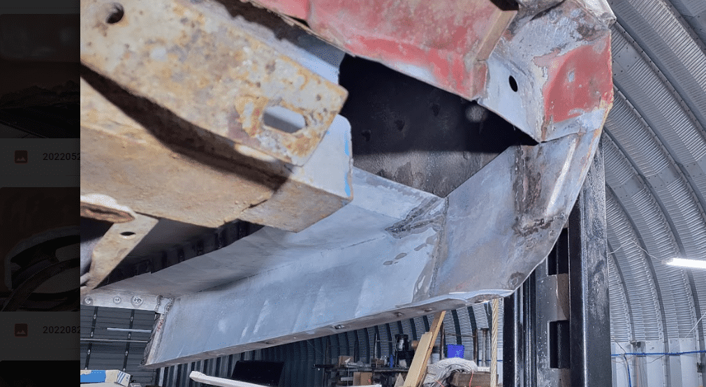

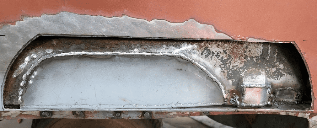

Repaired the inner wheel well
I made the large patch out of 2 pieces because of the complicated shape. It didn't fit perfectly on the left side, it left a little gap. I was bummed about that but not enough to try and modify it. It's a small enough gap to fill with POR15 Patch which is like a toothpaste-thick version of their rust encapsulating paint. I repaired a cracked cast iron outdoor water spigot with that stuff with minimal surface prep and it's holding up great.

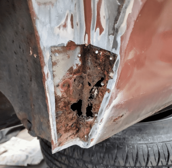

I could tell there was more great work done in this spot because there was lots of body filler and pop rivets poking out the back side
Sure enough, there was a piece of metal pop riveted in there
directly over rust holes w/ no attempt to repair the rust

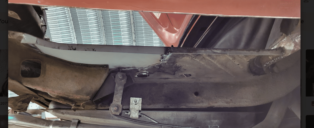

I wasn't sure what to do here. The rusty metal in this spot is sandwiched between the outer rocker sheet metal and the thicker inner rocker back bracing and I wanted to maintain that construction. Notice the 1/2" gap at the very bottom. It was filled with some kind of hard sparkly gray putty that I think was from the factory as it didn't match any of the other body fillers that I found so far.
After some pondering, I decided to cut the lip off the rocker and I'll weld a new piece back on so I can duplicate the way it was put together at the factory w/ the 3 layers welded together. I'll use plug welds
When I removed that piece, I felt a breeze of cool air waft out at me. I kind felt like I had just opened an old tomb and was breathing in air that had been sealed up for hundreds for years lol.
Looking inside I was relieved there was no more than some surface rust here and there and crud. I also could clearly see the thick reinforcing plate they put in for the convertibles. It looks to be 1/4" thick and runs the length of the rocker.
