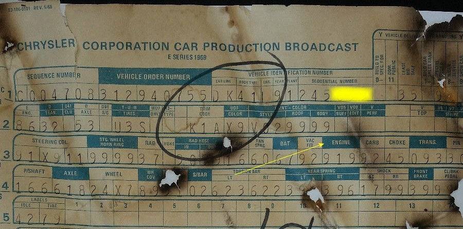

    Here's a BS from a 69 DK car. The engine assembly is 919 indicating the C body L code 440-HP, auto transmission and A/C.
    I do not have a broadcast sheet from a non "police" 440 HP C body to compare it to.
    Does anyone have a broadcast sheet from a 69 non 'police' C body with 440 HP, automatic and A/C so we can compare the engine assembly numbers?

    My 1969 "CHP" broadcast sheet has 919, that would tell me the CHP engine is no different than any other Police 440
    Alan

    My gut feel is it won't be different than any other auto A/C C body HP but we need to confirm that.
    Do you know if you car codes N97 for noise reduction package?

    There is a 7 in an unmarked box in the N section.
    Alan

    That's a typical location for N97.

    So what is the noise reduction package?
