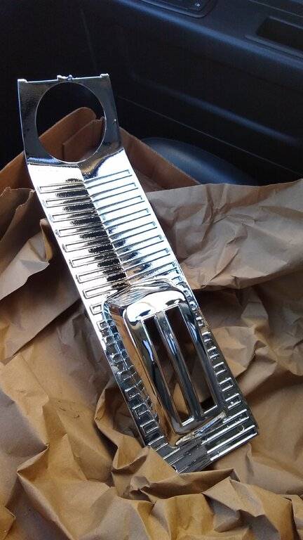

Hi. I recently was given the black striped center console plate for a 65 Fury/Polara. I had it replated and polished where it needed it. Looks great compared to what I was given.
Now... painting it. What rattle can color closely matches the Dull Gray Silver that covers the majority of the piece? The original wood panel plate I have has a very satin, semi-metallic look to the paint.
I hate to buy a ton of cans only to find the match is not even close to what I was looking at.

How about the black? I heard using gloss black nail polish will give it a real good look. I can't spray it because it will overspray on the inner walls of each slot...taping that would be a nightmare.
I'm thinking the nail polish would work well. Any thoughts?

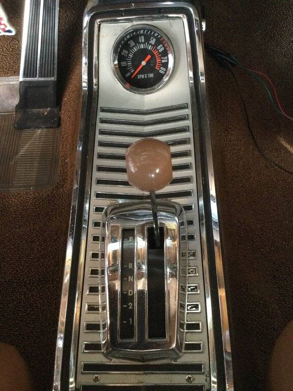

FWIW:
Here is my original plate in my Monaco.
Both the silver and the black were either a satin or flat finish originally.
How they painted it originally? I haven’t a clue.
Looks like it’d be a pain to mask.

2 hours later, only 4 of the "louvers" are taped. Obviously this will be a long process. Then I have to somehow rough out the chrome for paint.
One step at a time.
I wouldn't even rough it, just make sure that it's clean! I know the original ones are just plain smooth chrome, if you take the paint off. If you feel that you must roughen it, try a light dusting w/ a micro-etcher (sometimes called an "air-eraser") and 50-micron aluminum oxide.
