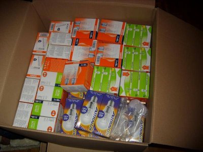

While we're talking about such things, start stocking up on incandescant bulbs for the house.
