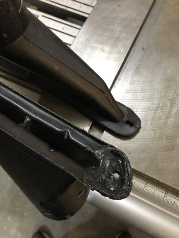

    I have had some success welding some of the plastic parts on my 68. I had to make some ears for my heater ducts. I ended up using a heat gun and some body plugs which seems to be close to the parent material. Since they go under the dash I wasn't too concerned about the looks. I had to recreate one of the ears
    Since then I bought a plastic welder from Harbor freight. It's muchmore precise. The difficulty has been finding the right parent material. I want to practice more before I weld my radiator rock guard.
