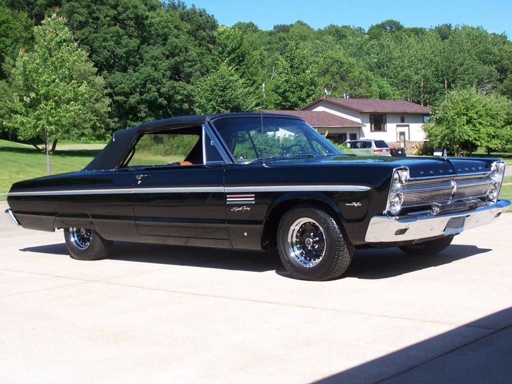

Without skirts I ran 275/60-15's on 15x8 American Racing Outlaw II's w/3.75" backspace on my '65 Sport Fury. Slight rubbing on very hard turns but otherwise was good to go. Of course, this was just on my car and they can vary a bit.
