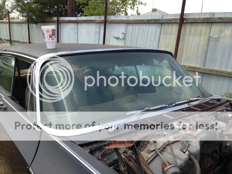

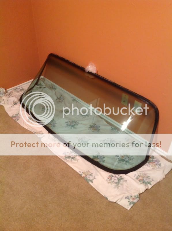

so apparently the ctc auto ranch had that book. apparently the windshields from a hardtop are the same as my sedan. anyway they had a windshield that was in good condition except for it had some spots around the edges that looked like bubbles. dont know if this is bad or not. anyway, I left a deposit and will pick it up soon...

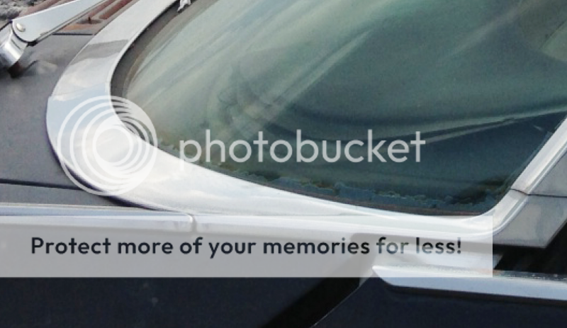

heres pics of the windshield I found. Ever seen that peeling/bubbling before? I felt it on both sides and it wasnt dirty or sticky on either side...
I would say that a '63 or '64 Chrysler should be the same, also possibly Dodge Custom 880 from 1963 or 64. Don't hold me to that, but those were the full-size cars in those years. The Plymouth's were B-bodies until 1965. :)
Thanks Wildaugust. Newport64, It's just the way you're looking at it. ALL CHRYSLER C-BODYS WINDSHIELDS FOR THE COUPES, SEDANS, AND 4 DOOR HARD TOPS ARE THE SAME PIECE OF GLASS FROM 1961 THROUGH 1964 INCLUDING THE WAGONS BUT NOT TO INCLUDE THE CONVERTIBLES OR ANY 1960's or 1965's. I hope this narrows your search, Jer
