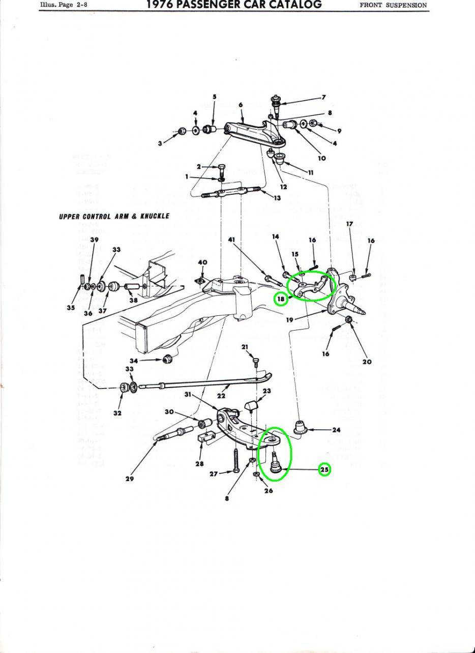

Here's a pic. Compare it to yours and you decide.
You need to use parts from a '69 -'73 as the ball joint is part of the swing arm (#18) on the older cars and starting in '74 they mounted the ball joint (#25) in the lower control arm.
OK , Thanks . Thanks for the info . I need a reason behind it to accept it .
I had thought if you used the lower ball joint from the early ones it would work .
I was kind of wondering why it wasn't common practice since they are plentiful in comparison to the early ones .
