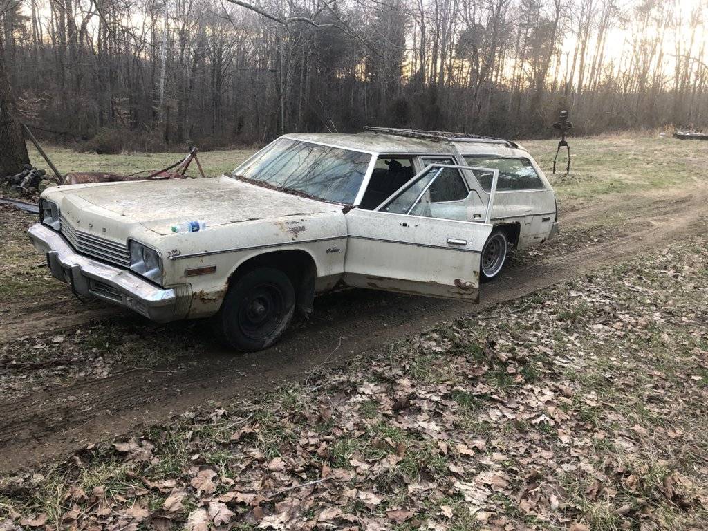

    My friend has this 74 Monaco wagon with title, no drive train and a 77 NYB that we think will run good. They are both 440 cars. The NYB has no title or keys. It’s solid as far as rust but, is in bad shape otherwise.
    I bought the NYB and passed it along to him so he’d have something to play with.
    We are toying with the idea of putting the drive train in the wagon and parting out the NYB. The wagon is not as solid as the Yorker, but not bad.
    What are your thoughts?

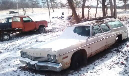

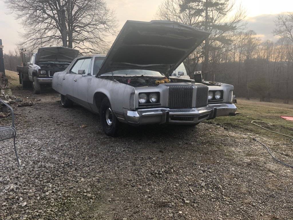

    The Yorker has 82000 miles around on it. We suspect that is when the lean burn went out and the owner gave up. (Long story). We got it to cough and run by pouring gas down the thermoquad and it sounded promising.
    Of course, this all depends on the Yorker having a viable drive train.

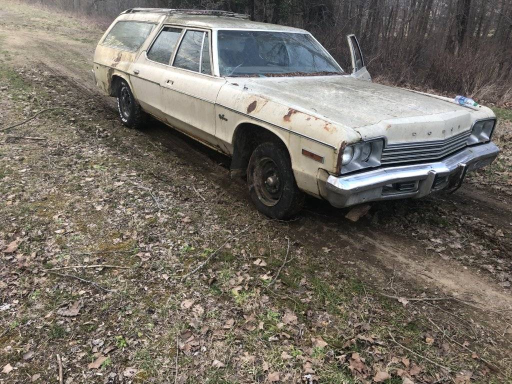

    Wagon shows a lot of rust, so you are probably better off leaving the running gear in the NYB. The wagon also looks like it has been sitting on the dirt for some time so there may be issues with the frame rails and such. I would look into filing abandoned vehicle paperwork on the NYB to see if a title could be obtained that way before going any farther. Both of these cars are going to be major projects.

    You should probably check the timing gears while you are evaluating the engine.

    Another thing you will want to check as the rear axle assembly appears gone from the wagon is that wagons usually have a wider track than sedans, the axle housing in the NYB might be too narrow to transplant.
