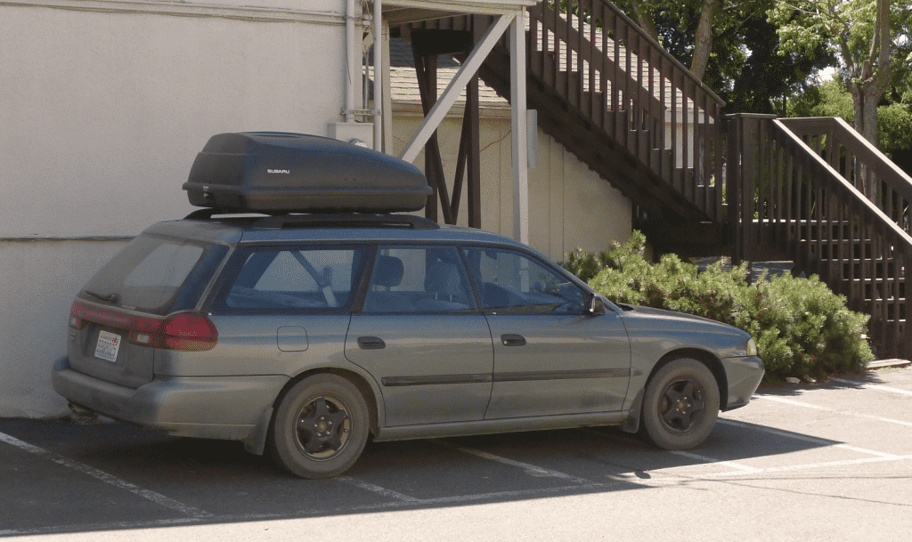

I've had great luck with most Krylon Satin Black when painting Subaru snow wheels, or even factory alloys like on my car, paint going strong for many a season now.
