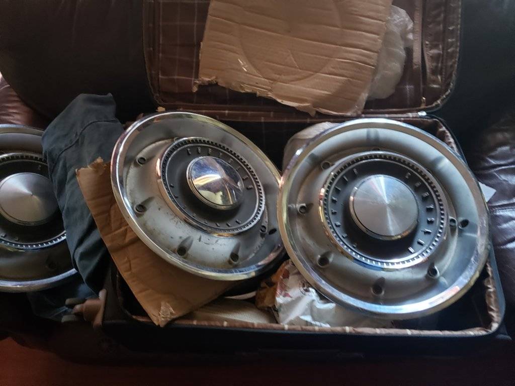

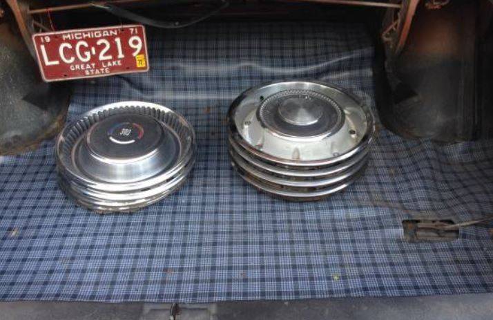

    So somewhere along the line of different owners, the wheel covers were lost. Here is a pic of the wheel covers that at some point were with the car. Which cover would of been stock, and which one would of been a upgrade? Also included the build sheet if that helps with what wheel covers came with car. Thanks!!

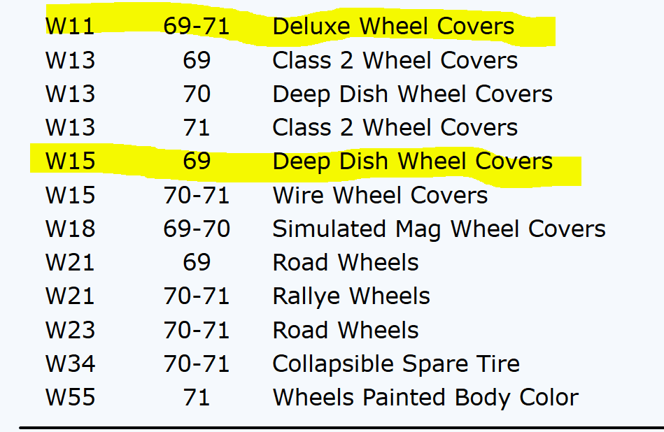

    Found this...
    W11 69-71 Deluxe Wheel Covers
    Would that be one of the covers I posted?

    If this is a Chrysler 300, pretty sure the 300 hubcaps are stock. The W11 code is not very helpful in this regard as the basic hubcap on many models was the poverty cap. The full wheel cover is designated by W11, but there are a lot of different ones across the different models. Higher end models like the 300 usually had a full wheel cover as part of the package and the W11 code would be appropriate for that cap. The best resource might be the dealer order guide. This appears to be a '69 model? The Chrysler 300 cars generally had the 300 script on the caps unless they were ordered with road wheels which was the W21 code.
    Dave
  4. Davea Lux
    Davea Lux Senior Member FCBO Gold Member
    Messages:
    4,809
    Likes Received:
    1234
    Joined:
    Mar 27, 2017
    Location:
    Cornelius Or
    The second set of hubcaps in your photo do not appear to be Chrysler hubcaps.
    Dave

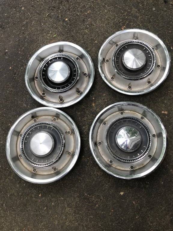

    I think its these maybe...

  7. GBsPanhead
    GBsPanhead Active Member
    Messages:
    309
    Likes Received:
    239
    Joined:
    Jun 24, 2018
    Location:
    Los Angeles (Whittier)
    Which photo?
    I've found both styles on ebay, but not sure which cover came originally with car. The one with the '300' embossed, or that '8 hole' style. That's what I'm trying ot figure out. lol

  9. Davea Lux
    Messages:
    4,809
    Likes Received:
    1234
    Joined:
    Mar 27, 2017
    Location:
    Cornelius Or
    I think the ones with the 300 are probably correct as they were part of the 300 package. But, as they say, if you know your way around a dealer order book, most anything can be made to happen.
    Dave
    • Thanks! Thanks! x 1
  10. Jim 68cuda
    Jim 68cuda Well-Known Member
    Messages:
    517
    Likes Received:
    260
    Joined:
    Nov 14, 2010
    Location:
    Virginia
    The ones on the left in your photo were standard. The ones on the right were extra cost option.
    • Agree Agree x 3

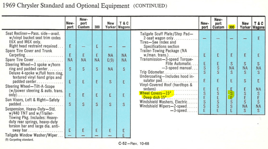

  14. ceebuddy
    ceebuddy Well-Known Member
    Messages:
    602
    Likes Received:
    268
    Joined:
    May 13, 2014
    Location:
    Frankfurt, Germany
    The left ones in the photo are the W11 which came standard with the 300. The right ones in the photo are the W15 optional wheel covers that were listed for $ 34.55 (and were also optional on all other Chrysler models except if equipped with road wheels)
