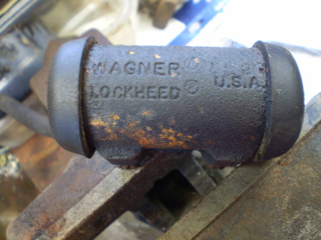

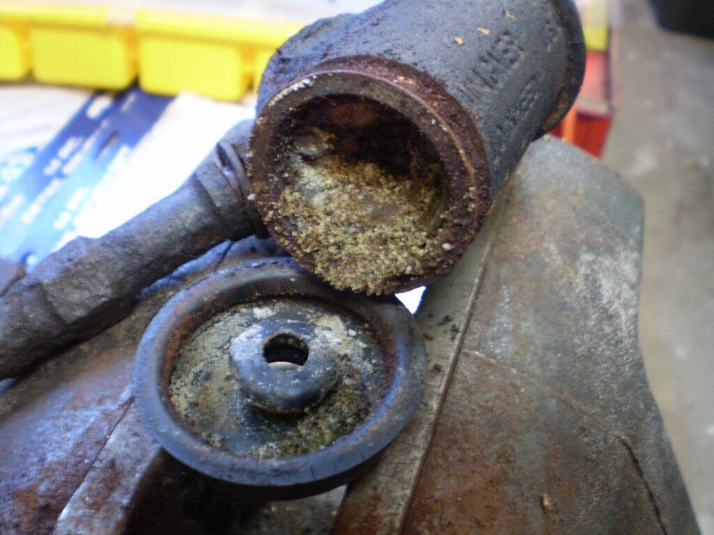

I'm going thru the brake system and when replacing the wheel cylinders I started thinking maybe I'd re-condition the original parts... until I popped the boot off. So I don't think these are good for anything are they? I bought new Napa (china) instead. In general is it a good idea to recondition old wheel cylinders ? (assuming they are in better condition than these were)
Notice those letters on the casting "USA"

IF the innards of that wheel cyl look like pictured, think what the lines might look like too! When you get it all cleaned up, check the inner bore with an electronic inside/outside caliper to see where things are.

You haven’t got close to knowing the condition of the bore. Need to get it apart and clean it, then you know what ya got. Remove all that crap and scrape off and crust before you try to get the pistons out.

With all that crud, there is a High likelihood that the pistons have "locked / welded themselves" to the inside of the wheel cylinder....
There is less than a 1 % chance that those wheel cylinders are salvageable / rebuildable --- and probably not even resleevable....
What are you going to have to spend in time and money is probably not worth trying to extend their life....
Your call..... Yours, Craig....
And...internet wheel cylinder Chineseum $ 1.29 kits have NO pistons......
