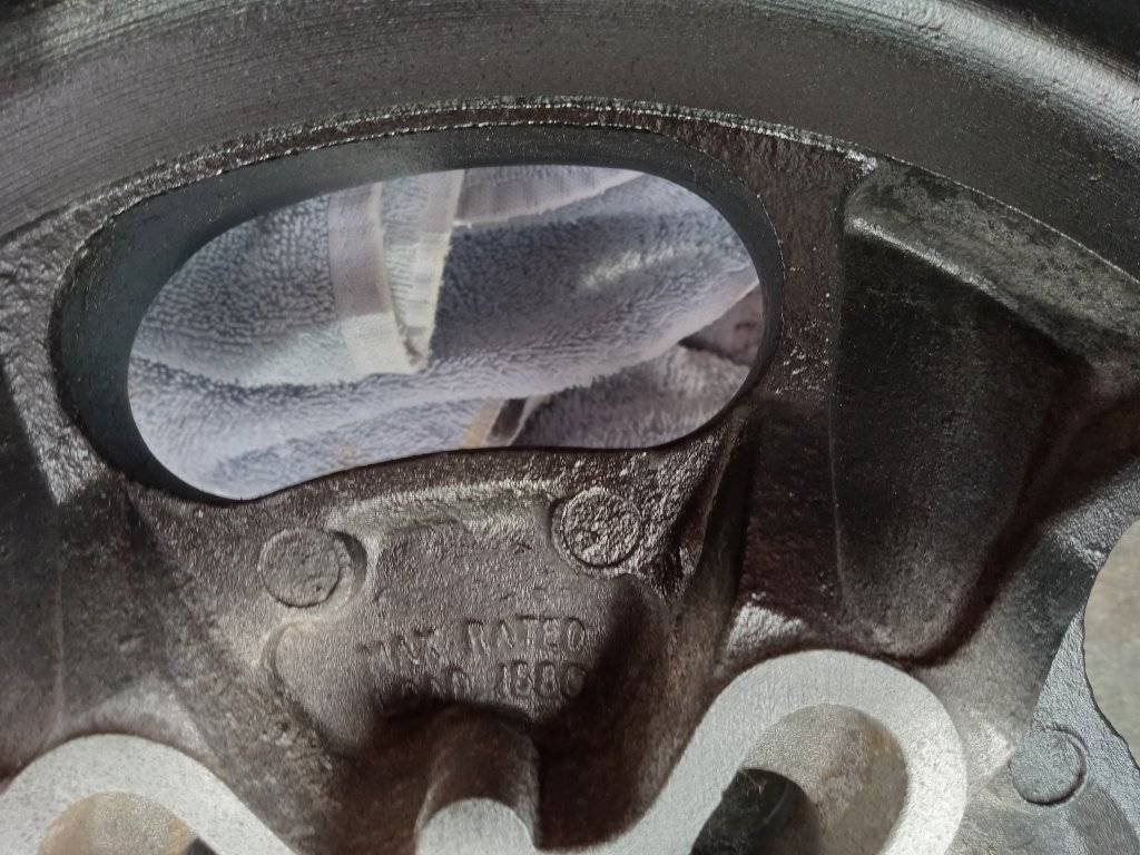

I want to discuss load weights. The wheels for the front are 14x6 Ansen sprints drilled for a 4.5 x 5 bolt pattern. Cast into the back of the rim is a load weight of 1580 lbs. That would be 3160lbs per pair.

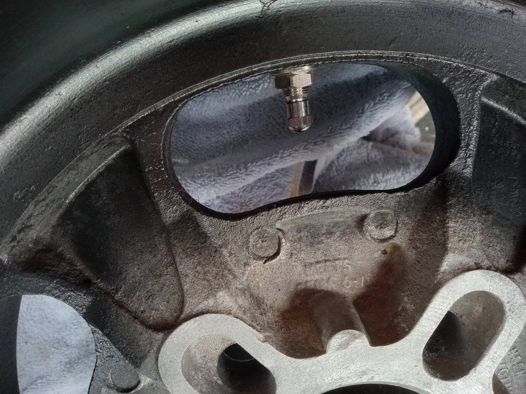

When the Specialty Equipment Market Association (SEMA) formed, one of the first things they did (about 1963?) was do build their famous "SEMA wheel specs" for their aftermarket wheel company members. So they took the SAE (?) OEM wheel strength specs and then put their specs at something like "5 to 1" or "6 to 1" of what the OEM specs were. I never have seen the OEM specs, so I don't know what they were. SEMA got a lot of traction with that new spec as when you bought aftermarket wheels back then, some did not crack as others did. Which, of course, could be a huge safety issue.
When they came up with their wheel certification spec, it was big news in the world of car people. It was covered in the big-time car magazines, too. "Look for the SEMA certification emblem" sort of thing.
As to the weight capacity stampings, most current aftermarket wheels usually have a weight capacity of 1500 to 2100lbs for each wheel. Usually listed in the "Wheel Specs" section listings for the wheels. Those weight stampings can also serve as the maker's liability limits, too.
Starting with the suspected 4000lb weight, do not forget to add 20 gallons of gas ((as most cars are shipped with about 3-4 gallons of gas in them (i.e., shipping weight)). THEN they used to consider that each passenger would weigh an average of 150lbs (which can be increased per person, as necessary, to about 200lbs each in modern times, to me). PLUS whatever is in the trunk (other than the spare tire and jack mechanism), up to about 500lbs. So what started out as 4000lbs could escalate to about 5000lbs quickly. Just an awareness issue, of sorts.
Back then, aftermarket wheels were usually in the realm of A, B, E-body Mopars, it seemed. Which would be fine for the stamped weights. I don't recall seeing C-body cars with "mags" on them, back then . . . few and far between. But if there were any OEM fancy wheels, THEY could be there. OF course, for a '66 Mustang or earlier A-body 'Cuda, they'd be perfectly fine.

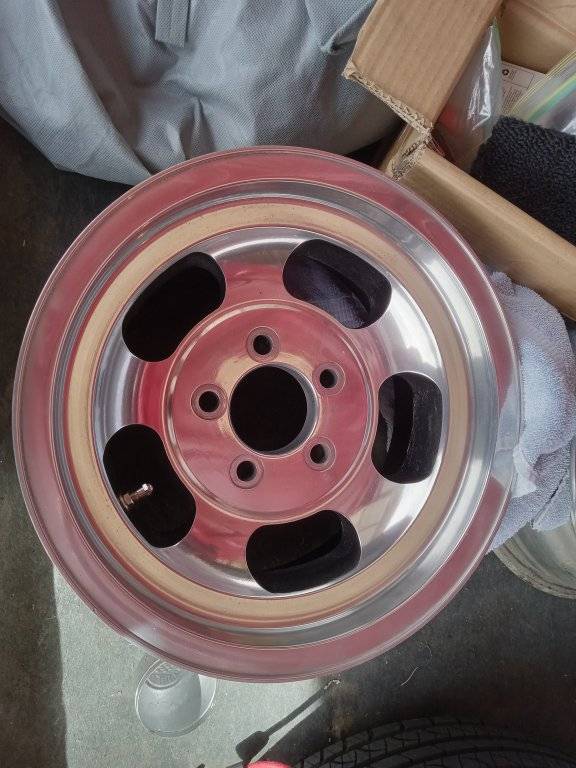

Thanks for responding. Here's a couple of photos!
