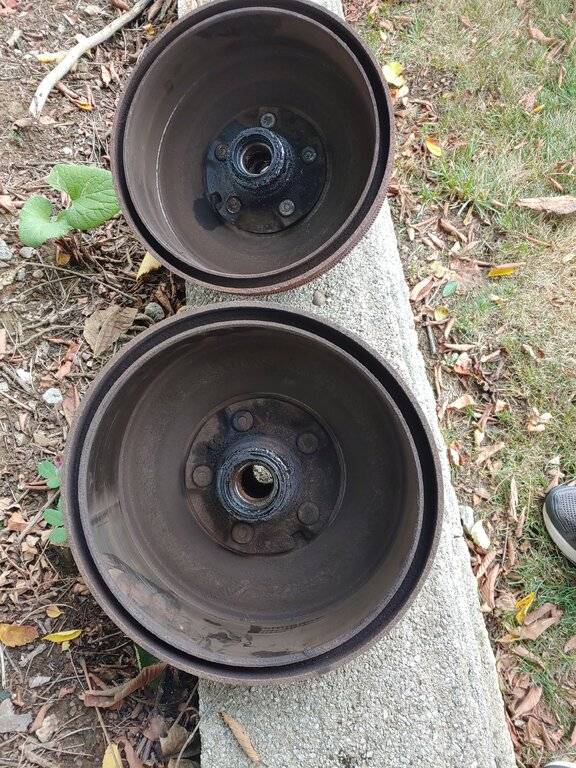

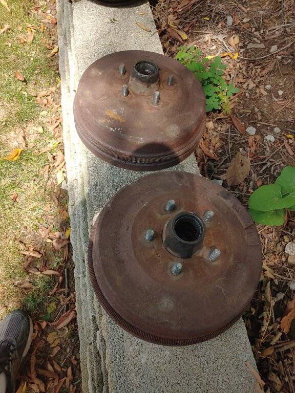

griswold00: I have a set of used drum brake hubs from my 68 Plymouth Sport Suburban wagon if your interested.

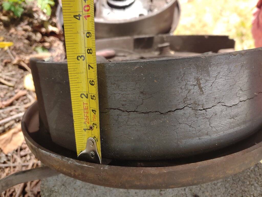

Hey CrazyBoutWagons! I just got off the phone with Craig (@mobileparts) and he gave me a great education about all the parts and pieces we are talking about. One thing he mentioned, and I confirmed is that my 66 Polara/383 does have the smaller 11 x 2.75" drums on it. I measured the drum pad and sure enough, just as he said, it was only 2.75" not 3". Now he also mentioned that there is a sneaking suspicion that the hubs on a 2.75" drum are actually the same as the drum on a 3" hub. Can you confirm if your 68 Sport Suburban was 2.75 or 3" drums?

griswold00 from memory i tihnk they were 2.75 .I will have to dig them out and measure them i will get back to you.
Griswold00: I measured the brake pads on my front end parts.The pads measure 2.75 in .The hubs are still attached to the drums I don't have access to a press at home I am not sure how to separate them otherwise maybe someone here can suggest how.
They have right hand & left hand threads as they were originally from the factory i think a couple have been changed at some point in time.
Griswold00: I .The hubs are still attached to the drums I don't have access to a press at home I am not sure how to separate them otherwise maybe someone here can suggest how.
I've pounded them out with a BFH, put the nuts on the studs so you don't mushroom them. Pound both the studs & the hub, it will eventually pop. Heat helps but I didn't have any at the time. Good Luck
