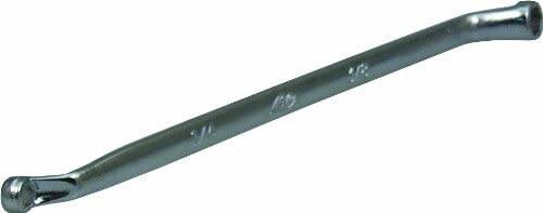

A brake bleeder wrench will save the day. Unless you've replaced the wheel cylinders with some of the new offshore sourced versions that is. I saw some where the hex on the bleeder was too big to use a wrench very well.
You can also use a socket, but that's a pain.

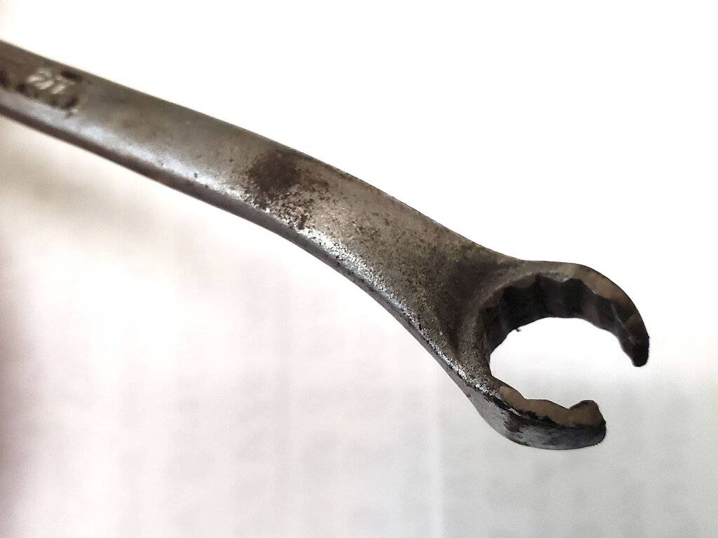

If you are referring to the two bolts that hold the wheel cylinder to the backing plate, you can grind down a box end wrench so that it will fit in that space.

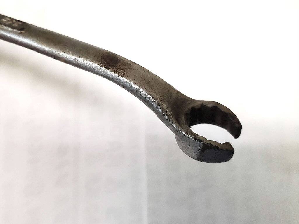

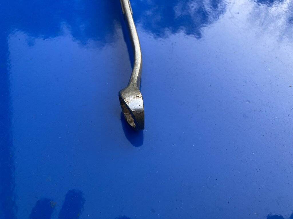

Here's my modified wrench. It's a pretty old Craftsman that's half way between a standard box wrench and an offset box wrench.
Jeff
I loosen the up the brake backing plate to swap the wheel cylinders, I think I will try the modified wrench next time. Got a hand vacuum pump (HF 15$) worked great, never do the two man again. Kinked 7mm wrench for the bleeder.

Grind down a old wrench, like Jeff said and leave the LCA bolts alone. Kink a wrench for the bleeder and get a vacuum pump. Nothing is easy.
Agreed, I will go the grinding route first.

Just wanted to update this, I opened a few more old tool boxes and found a box wrench that was already partly modified - someone had cut a section out of the front. With a little bit of grinding this did the trick and I got both front cylinders out.
