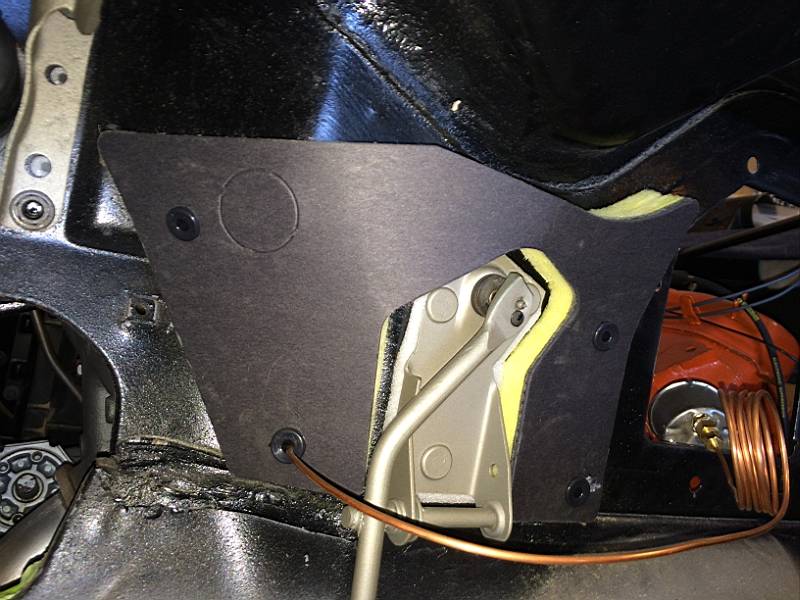

I want to run some alarm wiring through the firewall. Is there any pass through or grommet there that I could use, or do I have to cut a new hole? Also, looking for a nice waterproof boot to finish that hole.

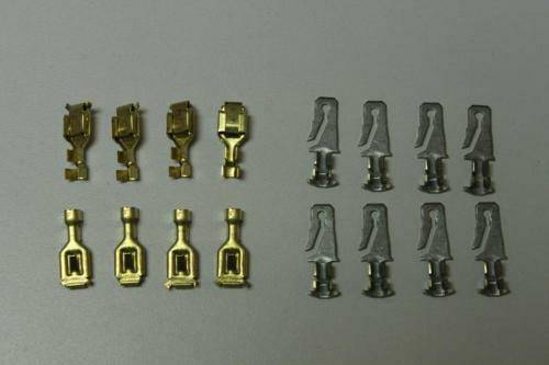

Take a look at the bulkhead connector. There's usually a few connections that aren't used. All you'll need is the connectors that look like these.
No holes... No worries about water etc.
But, IMHO, alarms are worthless. No one pays any attention.
No drilling needed and the grommets are already there, lots of them.
Just cut the tip off one of the insulation pins.

I'm a little leery of disturbing that bulkhead connector, as in dismounting it from the firewall. Could I use those spades you show, and just snap them into the unused slots in the plastic carriers?
I think I saw some restoration parts site on the 'web that sells those spades with the locking tabs-
Yes, you can just push the connector in from inside the car without removing anything. On the other side, it's going to be much easier just to unsnap the plug and put a new connector in. It's a good idea to take a few minutes to clean the contacts with Deoxit while it's apart, and something that I feel is a needed part of getting a 50 year old car's electrical system up to snuff.

The connectors are Packard 56 connectors. Here's some that are slightly overpriced.
Wiring Connectors Bulkhead Fits Mopar Dart Cuda Challenger Charger RoadRunner | eBay
You can buy them at NAPA stores too, but you need someone behind the counter willing to look them up and order them.
