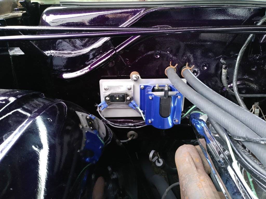

When I switched to an HEI I make a plate that bolted to the heater box bolts on the firewall and attached the coil to that plate.

On my big block, I mounted the coil where the fuel pump bolts on. Mine was a little easier to mount as I had a flat cover instead of a fuel pump there (using electric fuel pump). I had toyed with the idea of mounting the coil next to the distributor. On the same angle, using a modified mount. I had one of the mounts that clamps to the base of the coil, sort of stands the coil vertically. I have no idea where that mount came from, it was just in my stash. I'll have to see if I still have any pictures of either mount.
