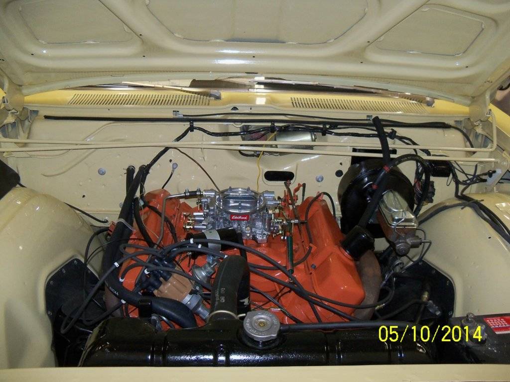

The stock appearing 520" in my 68 Sport Fury has HP exhaust manifolds with a little work to them, 906 heads with what I will refer to as a mid-range port etc. job and a factory steel intake and it runs on pump gas and has run a 13.45 1/4 mile @ 4,550 lbs, a 3.73 rear gear and G70-15 bias ply tires.
IMHO, if the engine builder takes into consideration the use of the car, the heads, intake and exhaust being used and flow tests the heads and knows how to match a cam (mine is a custom grind) then an awesome combination can be built using factory HP exhaust manifolds and a good exhaust (mine is a 2.5" TTI system). It is a matter of matching parts knowing how each part will effect performance. The other thing is that for our C Bodys, you typically want a torque monster under the hood to get the weight moving and with a torque monster stroker you are necessarily running high RPM's that require a lot of air flow. IMHO, spend the money on a quality bottom end that will last as long as you own the car.
