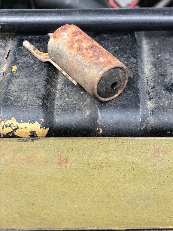

On a related note, this was connected to the positive terminal on the ignition coil. The wire had been pulled out. I'm embarrassed to say I don't know what it is. Some kind of capacitor or resistor?
Capacitor for AM radio static. Has nothing to do with your problem or how the car runs.
