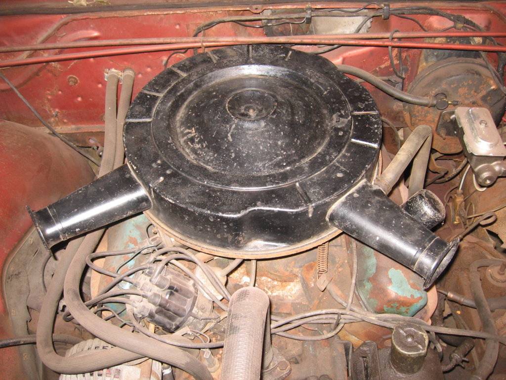

Are we sure it's a single round snorkel? I've only ever seen that up to 67. 68 and up use dual oval snorkels or no snorkels, and I've never seen a single oval snorkel... but I could be wrong.

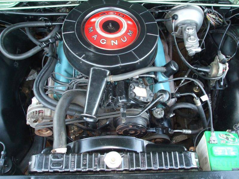

How about every Imperial of that era except for the few 68 that got a dual snorkel.:lol:

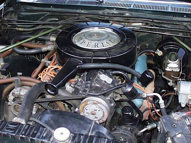

Right - the Imps got a single oval snorkel, with the snorkel necking down to a much smaller opening than at the air cleaner housing, yes? I would not call that a round tube, but an oval...
Like this:

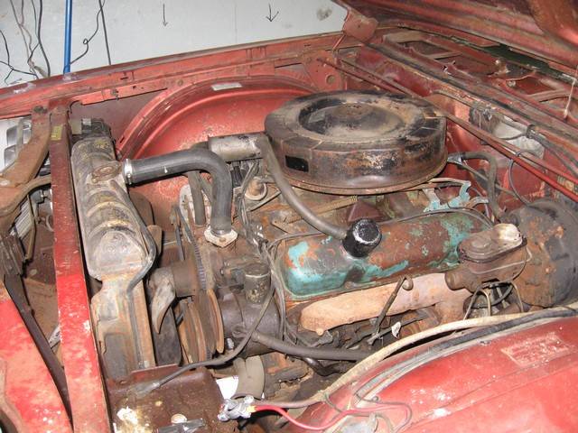

2bbl 68 383 single round snorkel....

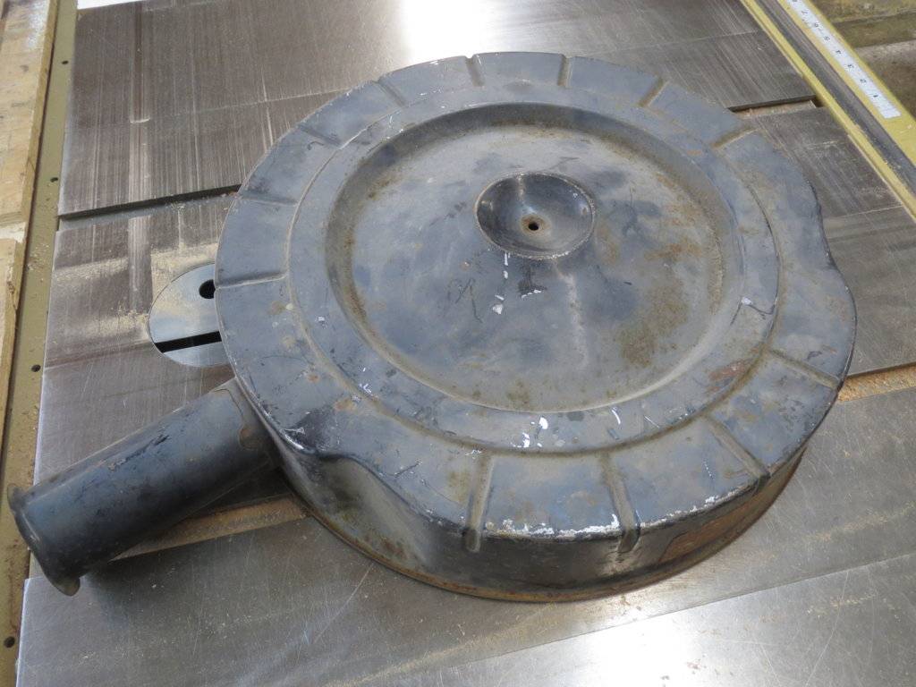

This style/type of air cleaner top is correct for the '65-'67 383s, 2bbl and 4bbl. Note the flare at the end of the snorkel! Compared to how the dual snorkel in post #14 has the "inserted" flares in the end of the snorkels, which I believe is for '68 dual snorkels. On this style of air cleaner, it's the base plate which defines if it's a 2bbl AND which 4bbl it fits ('67 used the small hole AFB, whereas the '67 Holley 4160s used the large hole, as did the '68 4bbls. Same part number filter element for all, including the 1968 Road Runner open element air cleaner.
Non-CAP cars in '67 did not have the closed breather cap, as pictured. The non-CAP cars had the non-hose snorkel and open breather cap (which usually put a small oil drop stain on the valve cover, over time. Not sure about the '68s, though.

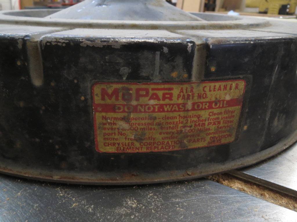

I’ve got this top that I’d part with for $40 + shipping.
