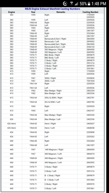

Thanks for the correction and guidance. I have eyed those Moparts casting number pages but could not make up my mind. Always better to ask the experts. Thanks again!

#2863409 fits 383-4HP for '68-'69
See www.mopar1.us/exhaustmanifolds.html
Dave
2863409 is also correct for a 68 - 69 "L" code (HP) 440 in a C Body (the list at the above website confirms this)
*** That chart posted by Newport 66 is incorrect in that it shows #2951216 fits both the 440 & the 383 for 70 & 71.
:stop:*** #2951216 is for the 383 only. #3418352 is the casting number for a C Body left 440 HP manifold. Refer to your parts book or scroll down at:
http://www.mopar1.us/exhaustmanifolds.html
The angle of the manifold outlet is at a different angle for the 383 HP & 440 HP C Body cars in 70 - 71.
Sorry to report that neither exhaust manifold that you have is correct for your car. The #3418352 exhaust manifold is hard to find (unless you break into my basement :lol:).
