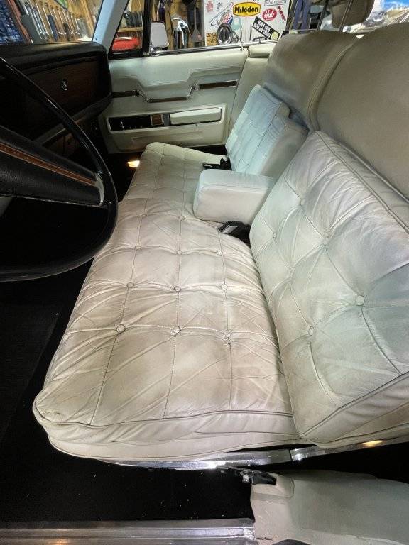

So Tux has some needs in the white interior. I had the seats rebutted and some firmness added, now my turn to freshen up the leather.
I have a couple of can of SEM super white spray.
I plan to do a serious cleaning and the some touch up of the colour with the SEM. A previous owner had sprayed a finish on it that ended up to be the reason for the dirty look.
If any one wants to jump in with tips or a don't list. Please feel free to add your thoughts.
Thanks.

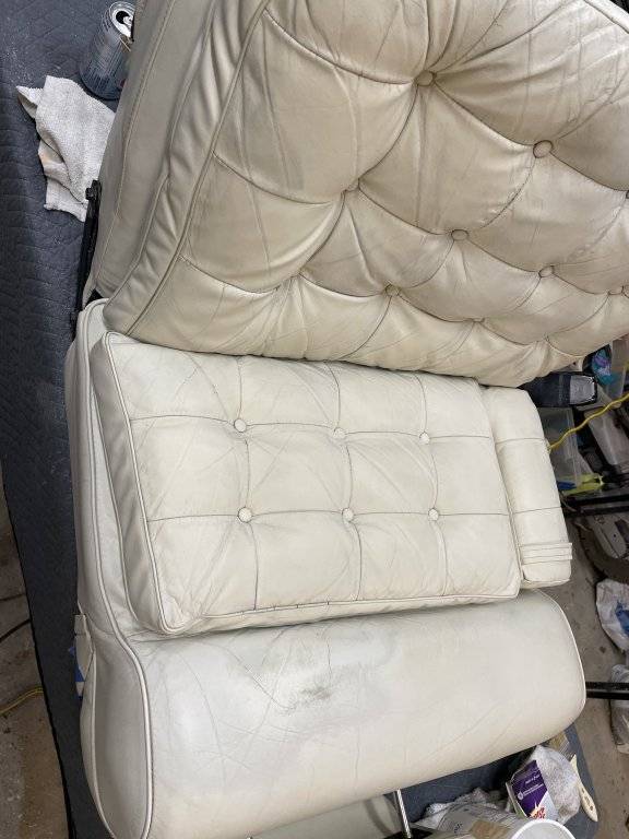

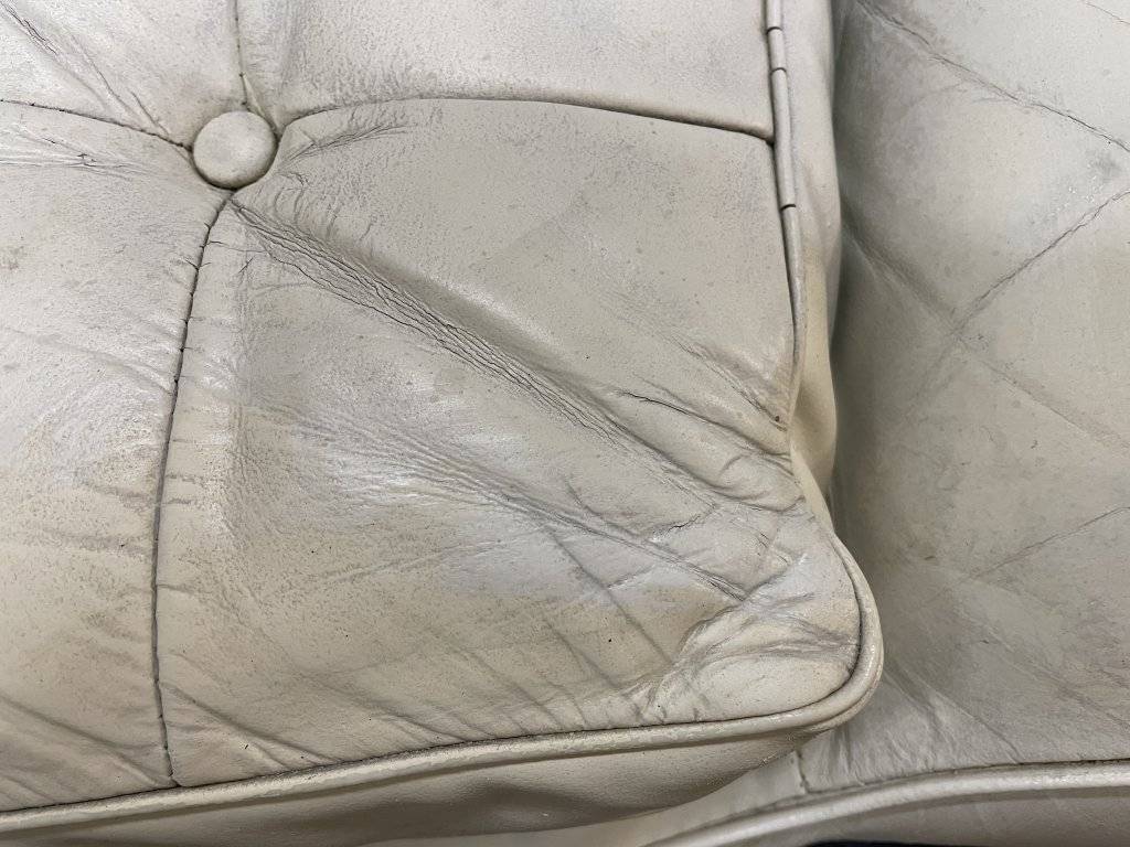

So the mess on the seats is not dirt, it is a paint. I have been at it for a while now using acetone in small areas with 2 " hair bristle brush.
the seats look much better once the paint is removed.
It will take much more time and work. Looks like it was a quick attempt to cover dirty white seats.

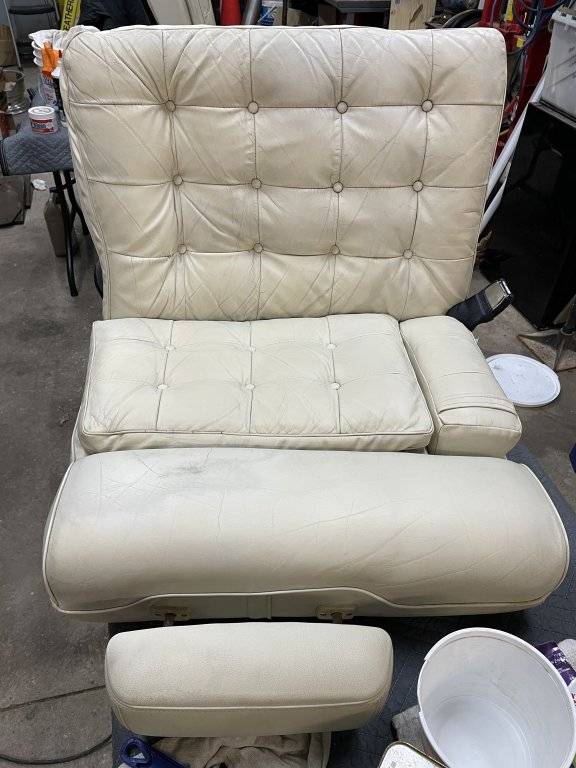

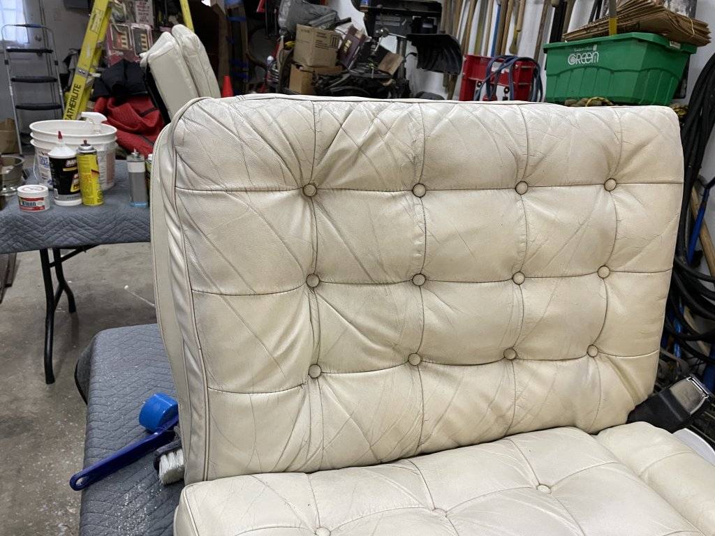

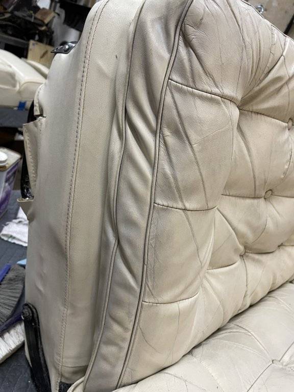

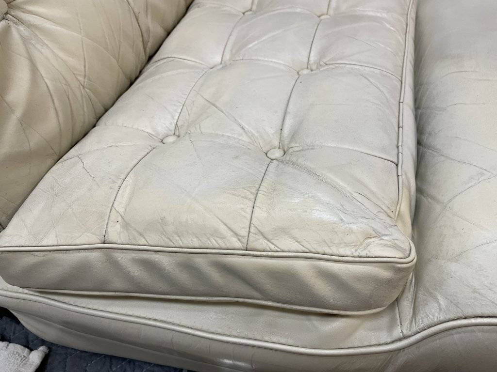

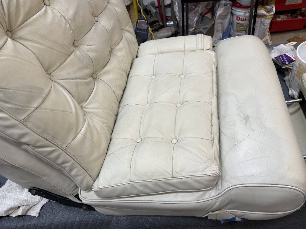

Some cleaning pics. The greyish areas are the old paint yet to be removed. Looks like the dark area on the upper back will have to be resprayed, it has been rubbed down to the real leather.
I have the Super white Color coat that my upholstery shop sold me. The upholstery shop says prep, prep and prep, then spray light coats. He says this will work. Stubs tells me above that it will not work.
I had a look at the SEM safety data sheet to see what the difference was from classic coat and color coat. This is what I find as base chemicals,
toluene
(propyloxy)ethanol
methoxy-1-methylethyl acetate
butanone.
I only plan to repair the upper back shoulder area that had been rubbed through previously. The lower seat cushions should clean up pretty good with lots of patients.
So all feed back is welcome.
