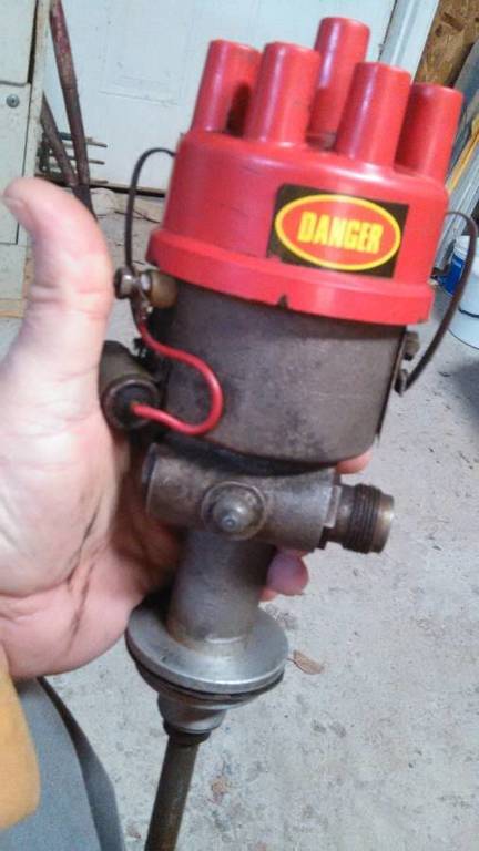

Judging by the cap and grease fitting, that's a Mallory dual point. Cool piece for a period restored race car, but kind of worthless for anything else. I think that's probably a smoking good price for someone looking for one... But that someone is few and far between. IIRC, this distributor will also have an adjustment for total mechanical advance.
The dual point distributor functions by having one set of points make the circuit and one set break the circuit. Any arcing of opening is then taken by one set and the same for closing. That gives you better point wear and a more stable dwell time. Usually there is also an increase in dwell time so the ignition coil has more time to charge. In theory, that should give you a more reliable spark, especially at higher RPM.
