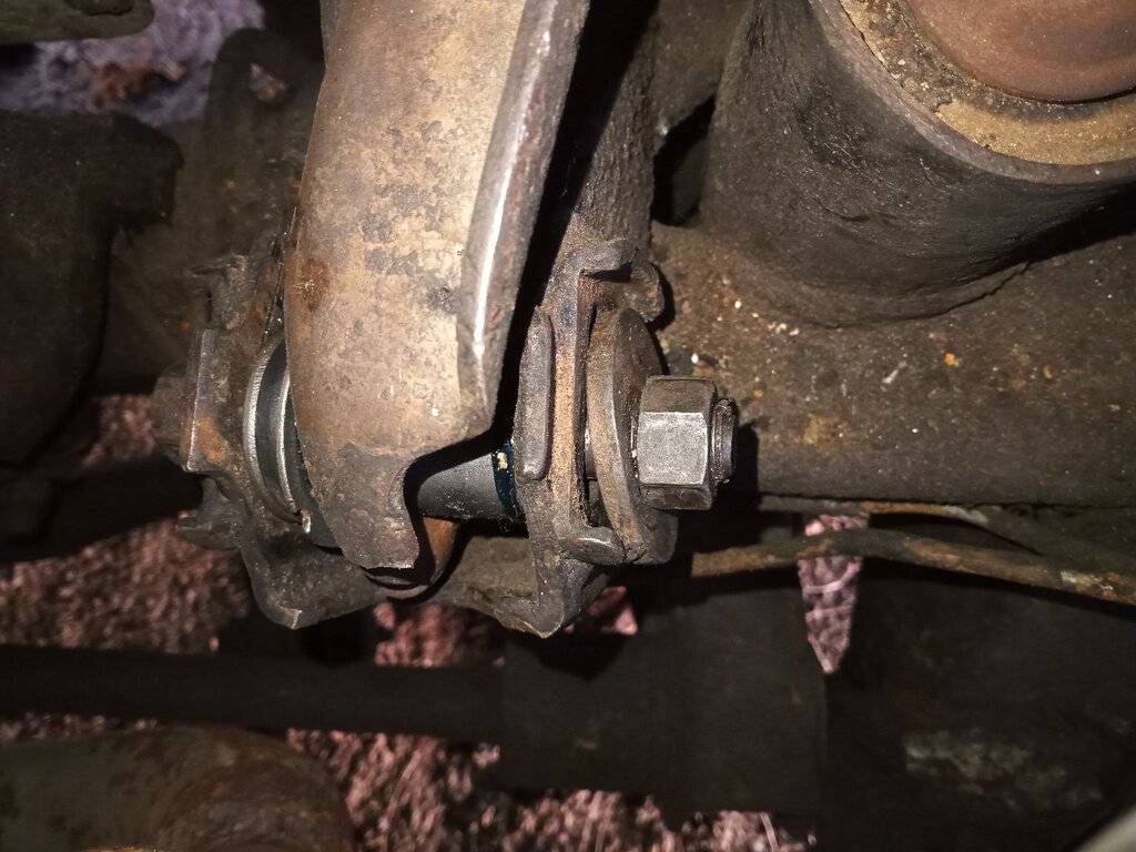

Update:
The UCAs fit, wasn't impressed he put them in with a vise instead of a press, but it is what it is at this point, the upper ball joints were bad also, so while they're lying on the bench....... The zone had them in stock!
"Ill press them right out for you" he says
NO DUDE, THEY UNSCREW!!!!!!
are ya sure?
Look at the FSM laying on the front seat!!
He didn't have the socket(of course) nobody else did either so it was kinda fun to see him struggle with the pipe wrench
Should have it back tomorrow
Doing the dual master cylinder upgrade as soon as I get it back
MYSELF!!
Then get those extra leaf springs out and she'll be road ready (knock wood)

Got it back yesterday
So is that quality workmanship or what?
I think I know why he was having a hard time aligning it
And no I'm not driving it, and yes its going to a local alignment shop that's been around 40 years

Got it back yesterdayView attachment 450615
Wow! I did better not knowing anything when I rebuilt my suspension, at least managed to get the disc in the mount. It's not that hard, if I can do it.
