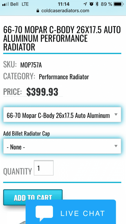

    I plan to replace the factory 22’´ rad on my 1965 chrysler 300 383 2 barrels
    First option: 26’’ cool casse MOP757A, does the trans line will fit?

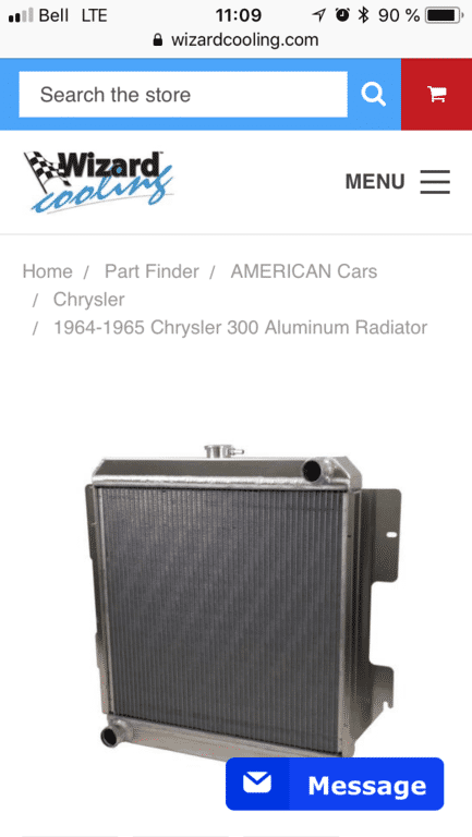

    Second option: wizard coolind 22’’ bolt on rad (more expensive)

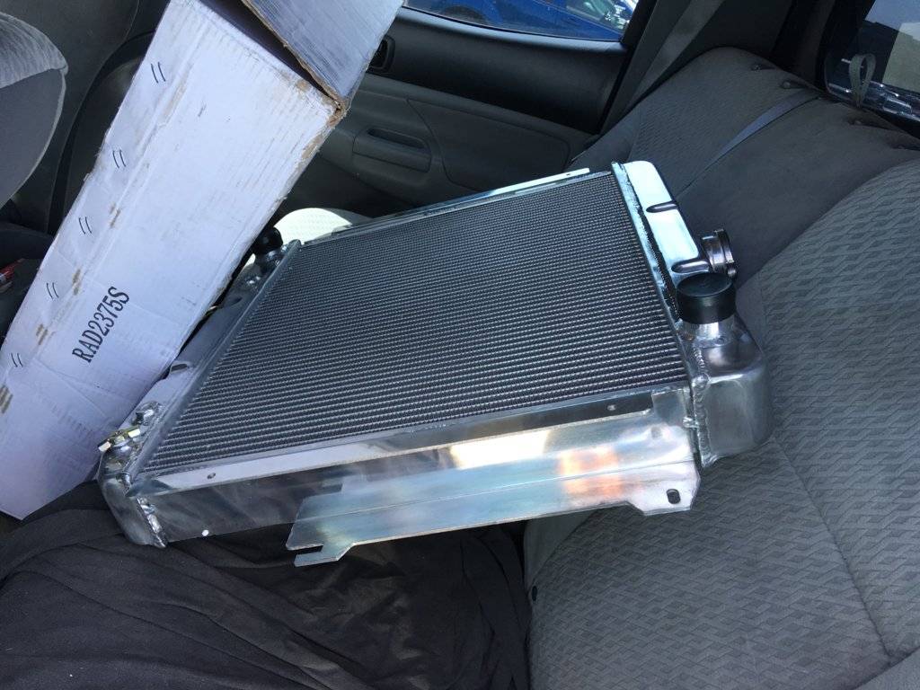

    I just ordered a 22'' rad from Engineered Cooling Products after my messurements! thanks to all of you!
