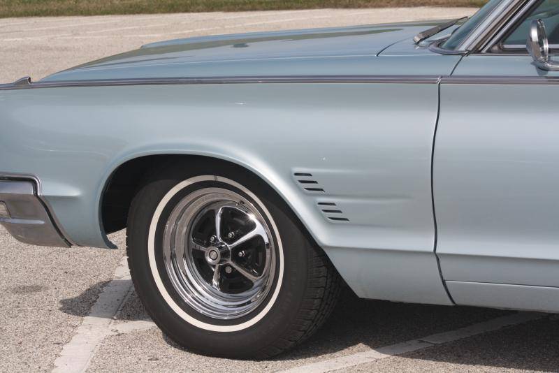

I have 235/75-15 Cooper tires on 6" Magnum 500 wheels on my 66 300 and it looks and drives wonderfully.
They are just under 29" diameter with no fitment problems at all.
