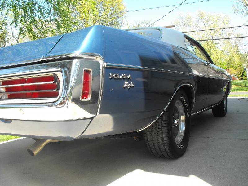

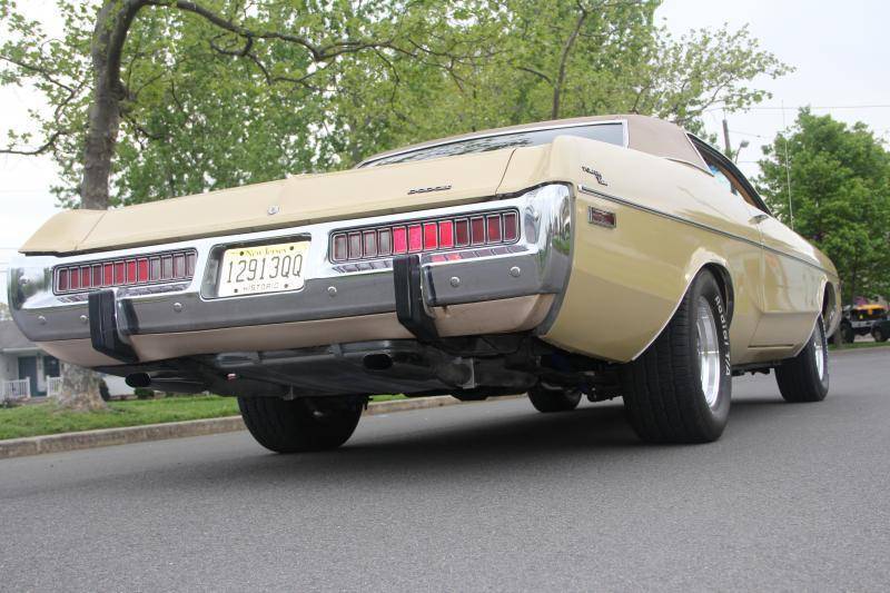

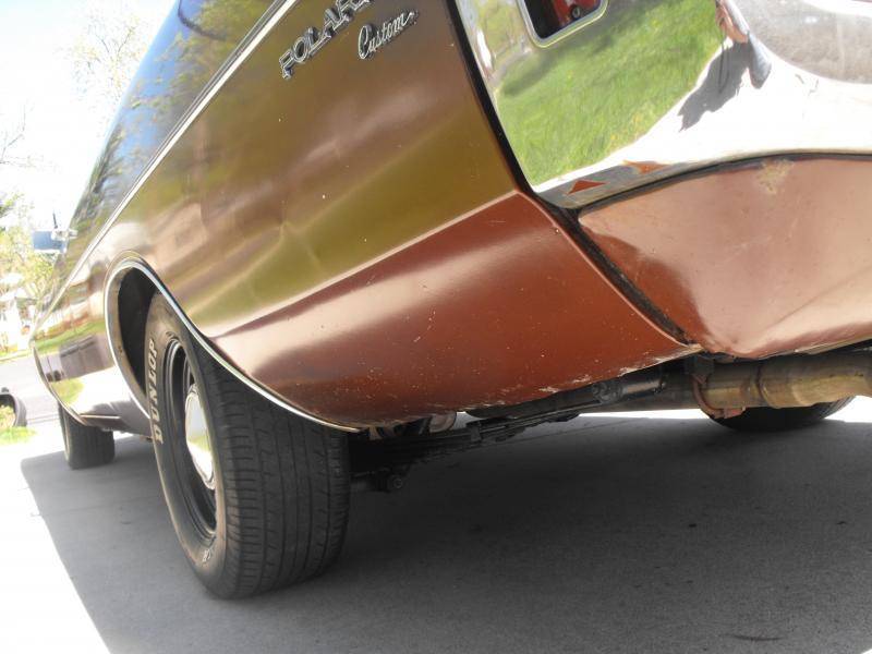

275 60's on a 71'
255 60's on a 71
275 60's on a 73 ..............
Note, the 275's on the 73 had one side slightly rub when cornering the other side had 3/4" clearance between the lip and tire.
