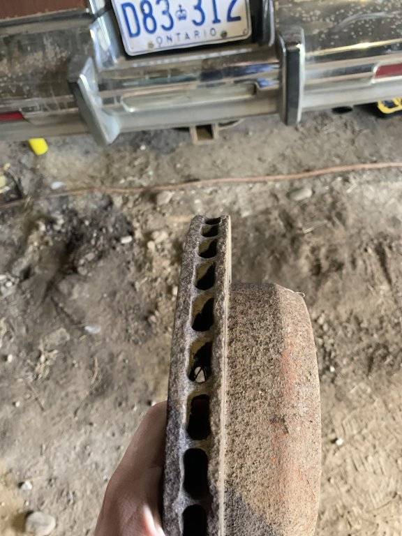

So the rear brakes on my '75 Imperial are pretty much shot, callipers are seized and the unobtainium rotors are on the way out, I would however like to keep some sort of disc brake setup for it. All of my searches for "9-1/4 rear disc brake kit" come up with only Dana 60/8-3/4 stuff, would those bolt up to my 9-1/4?

Thank you,
My rotors are, unfortunately, too far gone to put any money into the other components. The Napa website says that they sell pads and callipers for the Imperials so I would have gone for that if the rotors were good. I heard from somebody that '93-'98 Grand Cherokee rear brakes should bolt right up (both 9-1/4 axle with 15" rims) so I think I'll go that route, get away from the headaches the OE ones are causing
