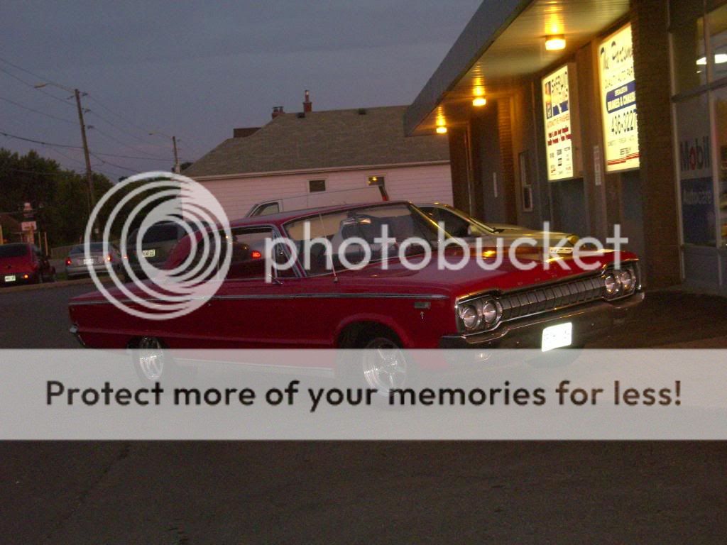

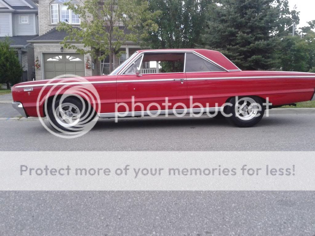

I have 2 cars 1 is a 1967 Dart and the 1965 Polara that is the wife's.
Here's some pix
And this is the dart and the new motor
wife's 65 Polara with a bb 440 it has a worn out 440 out of a motor home in it but I am putting together a 446 with a 71 HP block / H beam rods / Venolia flat top pistons / with Eddy open chamber heads and 605 Doug Herbert solid roller cam and a new727 trans with a 3000 stall also have a 3.55 posi 741 unit that's going in for next summer should scoot along a little better than it does now LOL
