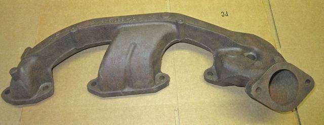

Here's what you have:

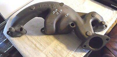

And here's what you want:
Note the different exit. I have the b body manifold on my Fury out of my 18 year old ignorance. It works, and works fine, the upside is number 7 plug is easier to change. The downside is in my mind because I know it's wrong for my car. I didn't fab the headpipe, muffler shop did it, as best as I can recall they had a bit of a hard time of it, but I'm not sure anymore, 45 year old memories aren't too reliable.
