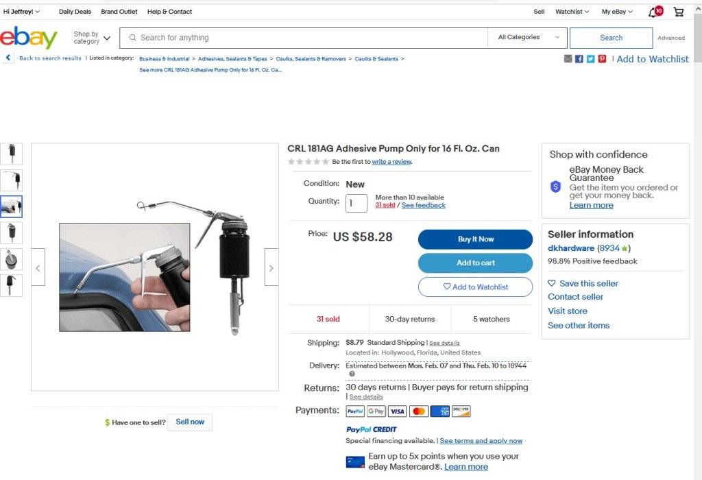

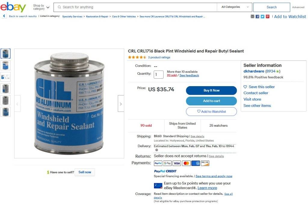

The official product used for decades to seal the glass to the gasket was liquid butyl. Looks like there is still one company that makes it. It comes in a pint can that you can attach a hand pump to. You stick the nozzle between the glass and gasket, then pump away. It can be messy, but it works well and cleans up fairly easily with mineral spirits.
Pump: CRL 181AG Adhesive Pump Only for 16 Fl. Oz. Can | eBay
