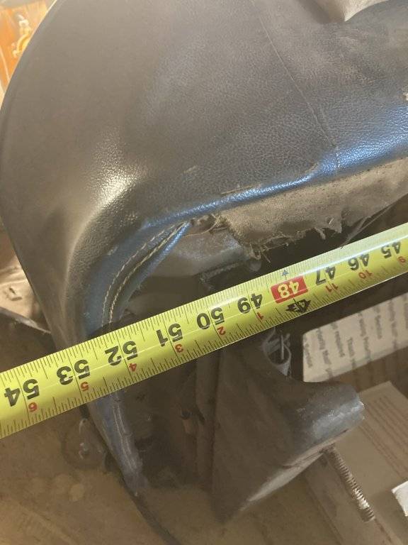

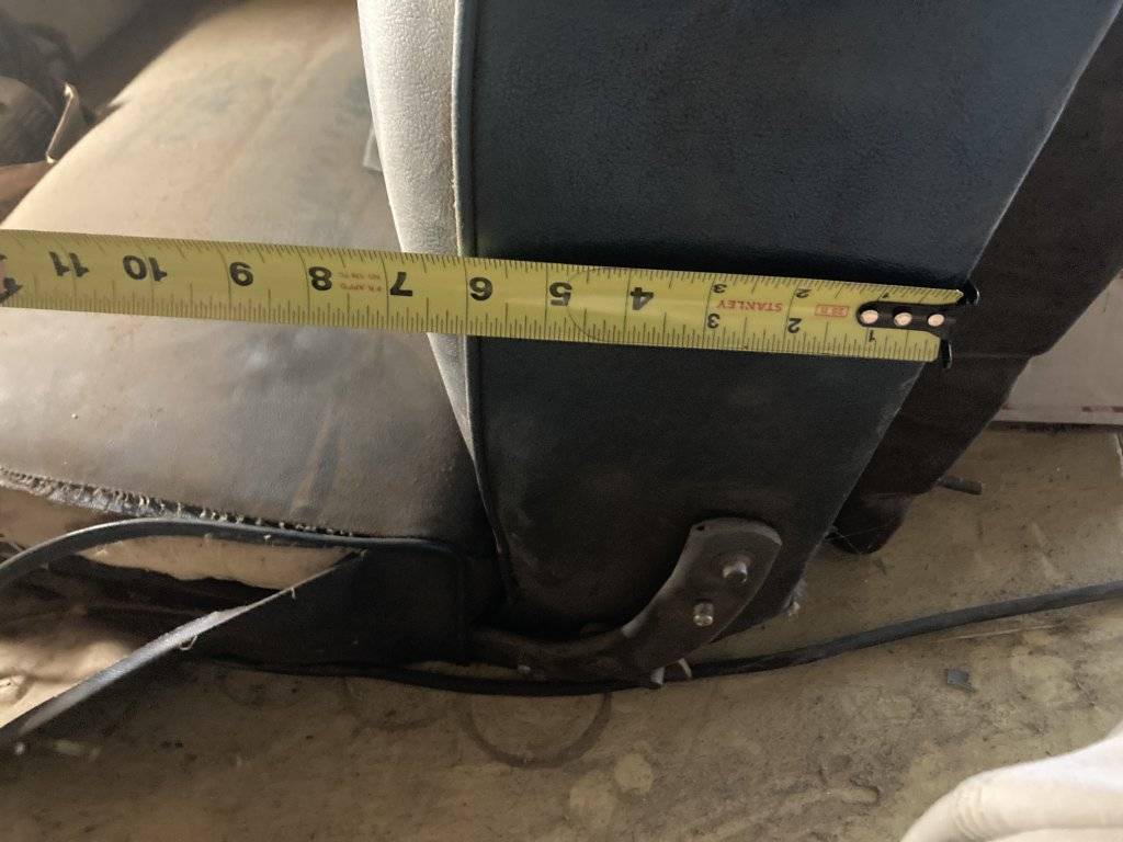

Front bench removed from the ‘69 Fury which has its original and correct upholstery still on it is the same physical size as the known B-body bench that I have for my Road Runner. I’m not saying that the frames are identical in every detail as it would take some more time to get the 2 seats next to each other for further comparison but they’re the same size.

I will not tell you that definitively B-body seat covers will work without a hitch. Check these dimensions. The pics below are from the B-body seat.
