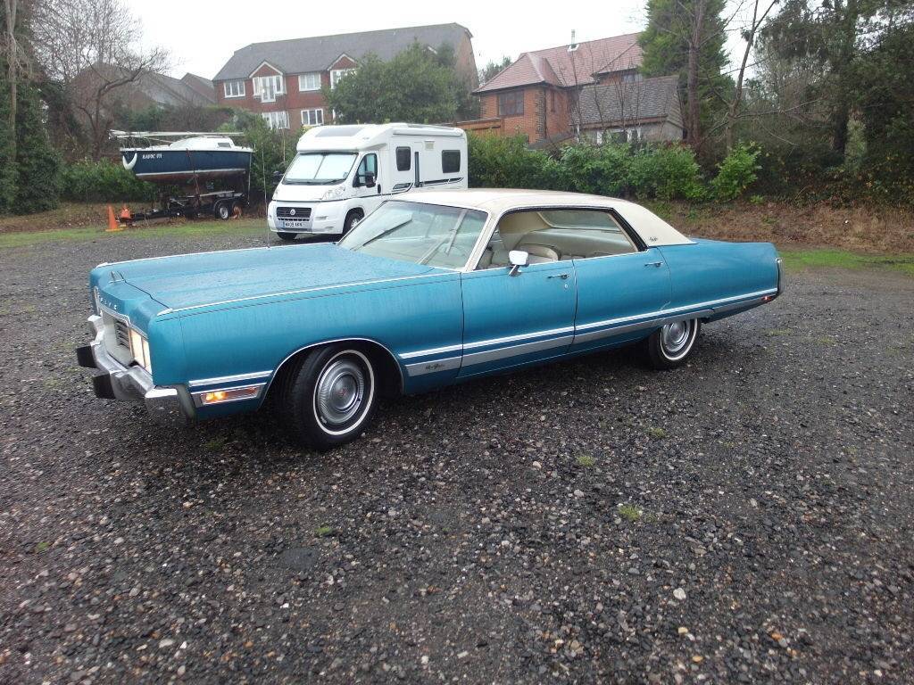

4x 8" x 17" American Racing 5 spoke alloy wheels
4.5" PCD - Ford 5 bolt pattern
4.5" backspacing
ANY HELP THANKS DAVE

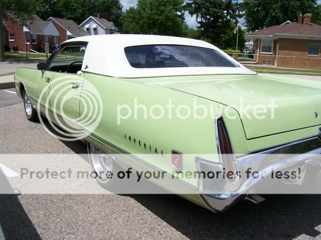

Here are 17" AR rims on my '73 Imperial. I tried to show pics that highlight the wheels/tires. In my opinion, you do need the whitewall, even if that means "spinning" a set of SUV white letters into a whitewall. At the time, you could get Michelin 225/60R17 WW's that were OEM on Lincoln Towncars. Wish I'd bought some extra sets because I don't think you can get them anymore.
Majority of broad market tires with whitewalls including the Michelins you mentioned are dicontinued.
Diamond back Tires do sell 17 " whitewalls at a Premium Price $$$$
The spinning of a current whitewall idea I like but must be done with care and safety first,LOL!

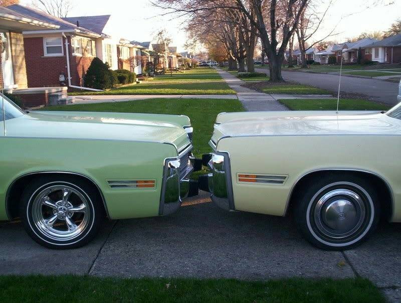

Beautiful car. I especially like when you can tell the American car isn't in Kansas anymore, Toto.
