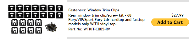

I did find that 521 Restorations has most of these in their glass section. 521 Restorations - Glass
The Fury kit below should be the same for the '68 polara with vinyl top. They do not have the Polara with the vinyl top listed separately.

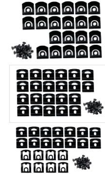

I am thinking the green on the left are 6001084 for the rear window upper and side trim. If the picture above from 521 is to scale then the blue on the right must be 6001648 for the upper and side front window trim?

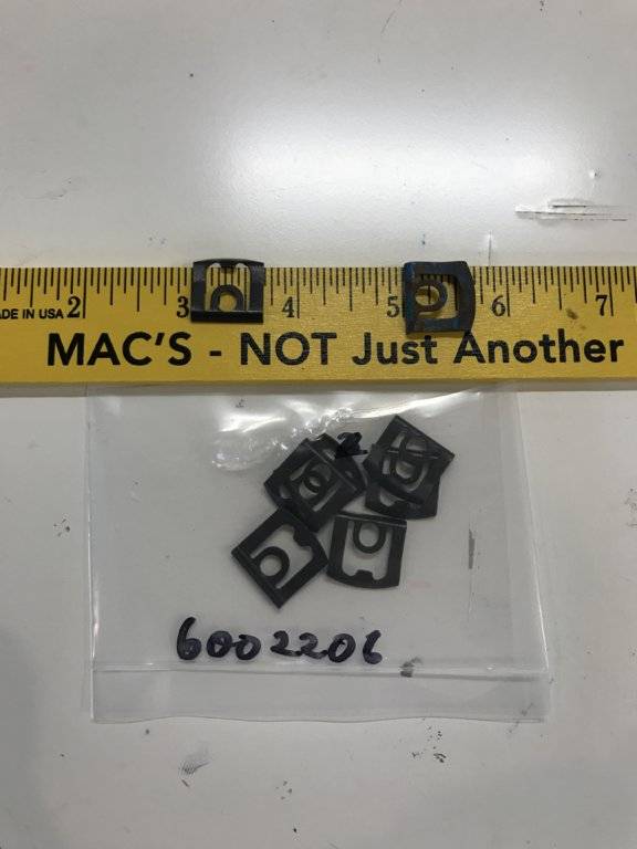

For some reason I don’t have any samples of 6002206 rear window lower trim for vinyl top or two tone. Maybe because when I sent it away with the rear window in and I couldn’t take them out?

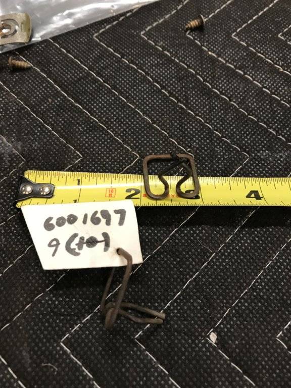

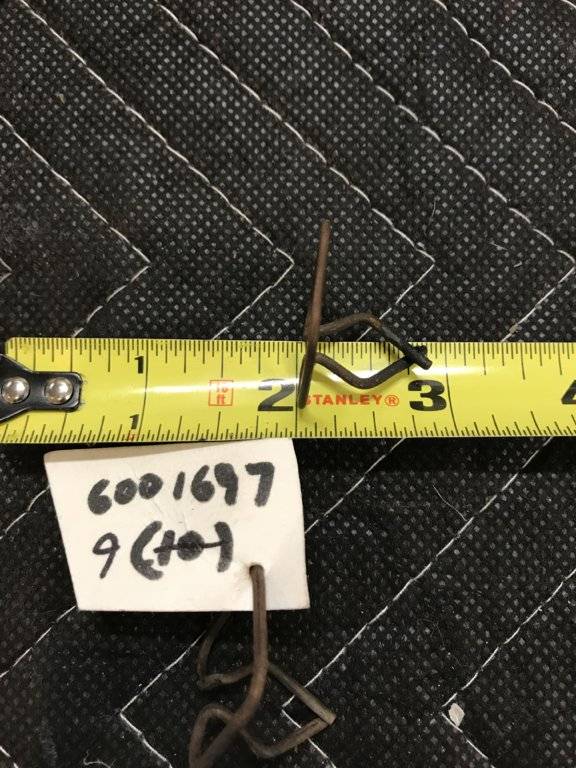

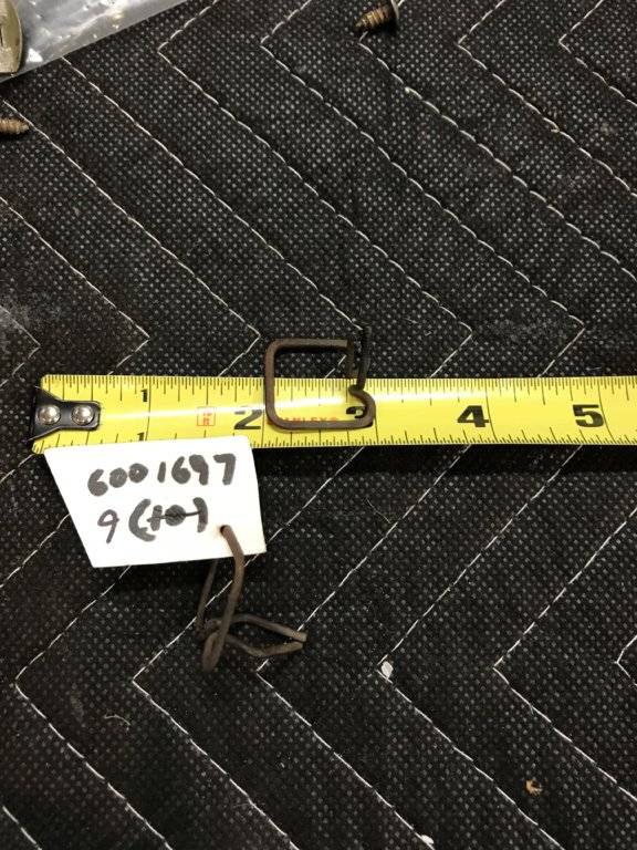

Windshield outside lower retainer p/n 6001697. Parts book says 10. I only have holes for 9.

Rear lower w/vinyl p/n6002206
