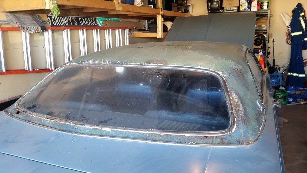

Anyone care to send me in the right direction for removing the stainless around my back window and windshield? The trim has little to no wiggle room against the glass and I don't want to spend money on replacement glass or trim. Do you pry from the glass side or the body side of the trim? The car in question is a 69 Monaco 2 door.

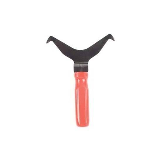

The clips are in the channel, approximately perpendicular to the glass face. Use a wood or plastic wedge to lift the trim from the glass, just enough to get the tool pictured in and behind the clip, pull clip out, push trim up with the same tool, repeat. Sorry no pics. If that doesn't make sense, the only other thing I can say on the subject is to install, if all is right, trim should easily be bumped on straight down towards the windshield/backlight.

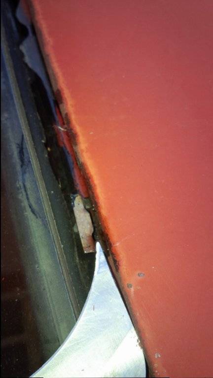

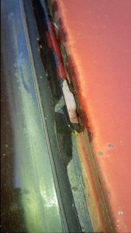

I have my trim off right now. I will take a pic of the clips that you are trying to "hook" with that tool. Basically the clips press against the trim holding it in place...you have to hook the clip to relieve the pressure just enough to clear the channel and then it just slides out.

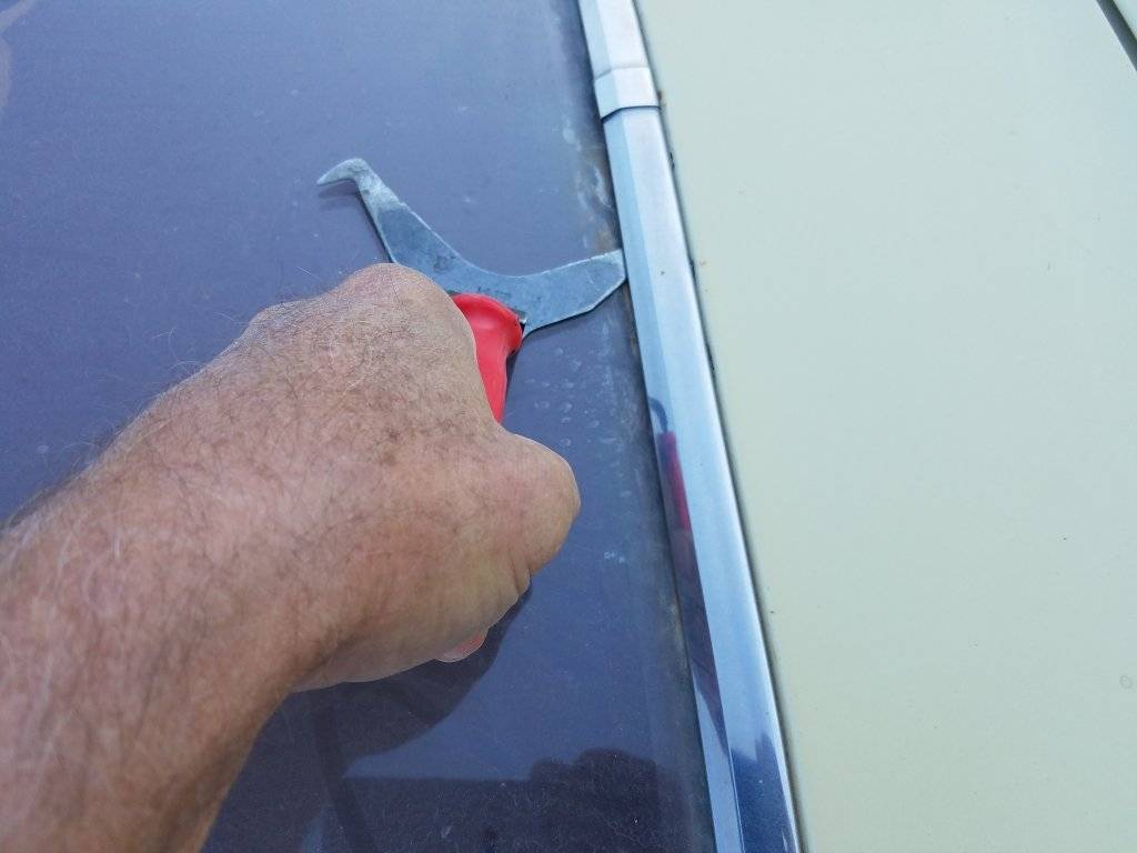

I didn't find it difficult to figure it out, bought the tool and just dove in. I didn't even know what the tool looked like till I went to NAPA and told them what I was trying to do.
The clips are perpendicular to the glass, you are trying to hook the clip with the point of the tool the rock the tool on the heel opposite the point. The tool will stay flat to the glass as you move it, it will only need to move an inch or so. The hardest thing is locating the clips depending on how much sealant may have been added.

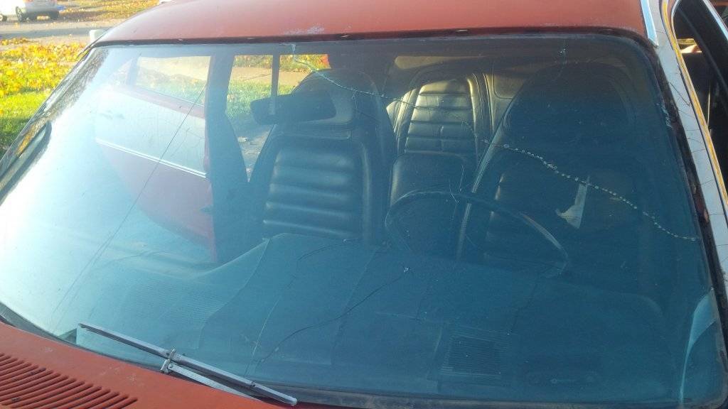

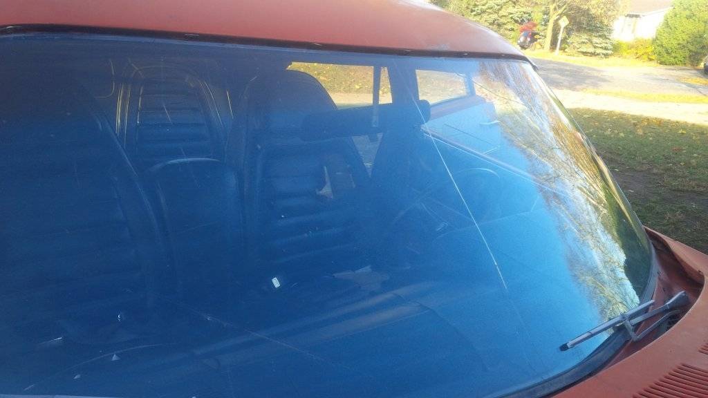

I actually took these pics earlier today but I don't think they are close enough for you to see. I will take some better ones tomorrow. I would start on the front window...unscrew the lower mouldings at the base of the windshield first, then start at the bottom and work your way up to the top of the windshield. Do one side and then go over and start the other side before you do the top. If you aren't tall you may want to get a stool.

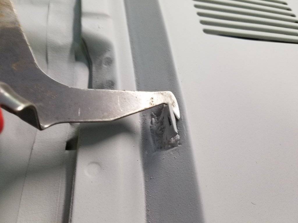

Here's how the tool goes in and what you are doing to get the molding off the clip. Pull up gently on the molding while releasing the clip with a twisting motion with the tool. It's a bit tricky to get the first couple clips loose but gets easier as it loosens. Hope this helps .
