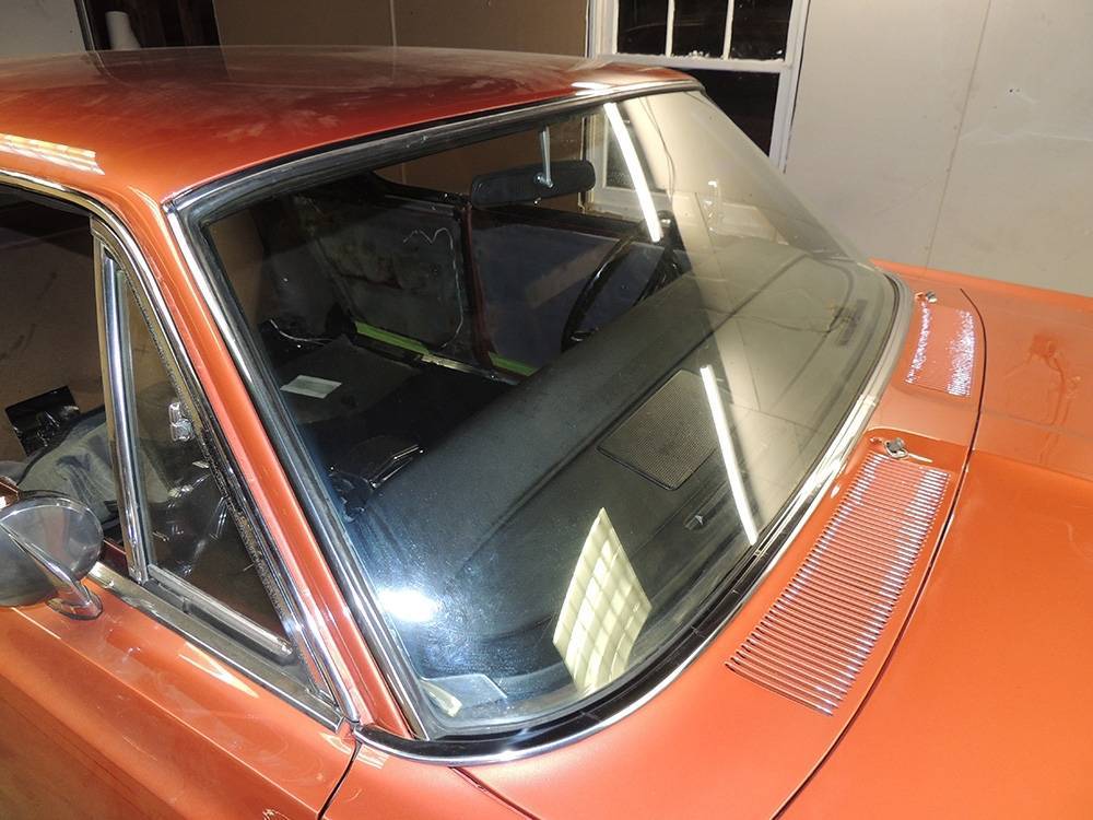

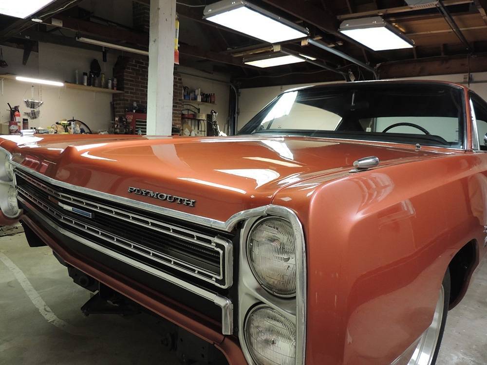

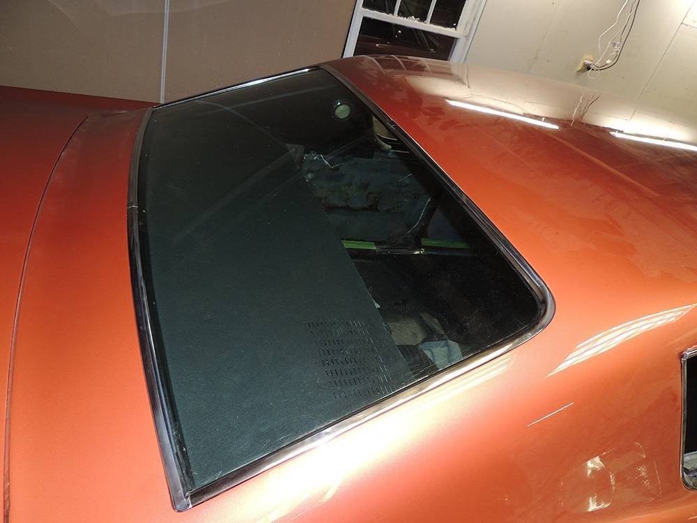

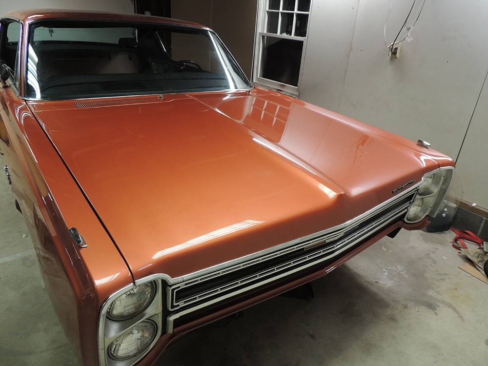

A few pics as promised.
Looks great. Did you use any type of sealer under the front gasket? I've watched a few video's and some guy's used a silicone type sealer under the front gasket, and some didn't.
Factory used butyl sealer, so did I. I put a decent amount of it in the bottom channel and between glass and gasket. After the glass was in I back filled the gasket to pinchweld area from inside (not possible to do from outside).
