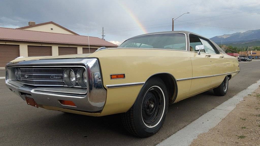

If anyone wants to see the car, this is what I am talking about.
She does get neglected behind the cuda and the harleys. But she is clean and covered.

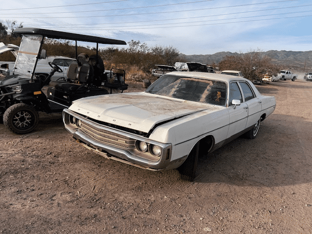

Check out DVAP in Arizona. They are parting out a 1971 Polara -- I should know, I bought that very car's trunk lid to replace Medina's, my 1971 Monaco (the edge on the latter looked good from the outside but was rusty under the bright trim). AFAIK, the windshield is in good condition, @azblackhemi has seen that parts car and should be able to confirm.
1971 Dodge Polara Custom 4 Door Sedan (#71DG4348B) | Desert Valley Auto Parts
In any event, DVAP have multiple other fuselage C-body hardtops and convertibles that would work here, including:

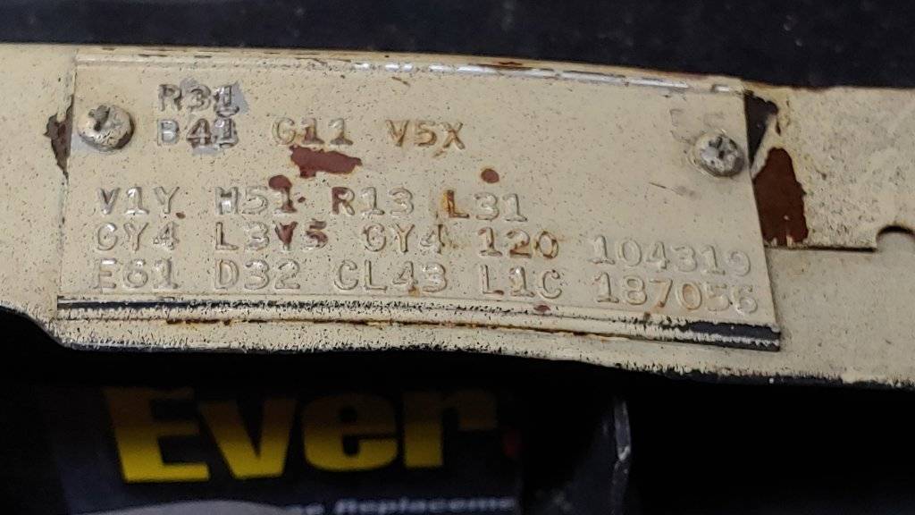

--> 1970 Chrysler Newport convertible (I am hoping that @azblackhemi might be able to get the VIN or fender tag):
1970 Chrysler Newport 2 Door Convertible (#70CR0841B) | Desert Valley Auto Parts
