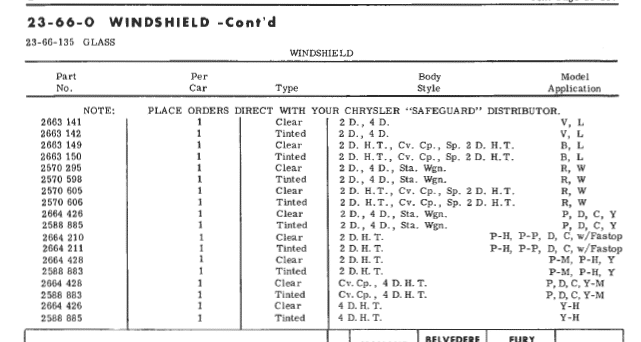

I checked the search feature and found conflicting results. I'm going to the junkyard this weekend and want to get a set of windshields for my 67 newport fast top. They have a newport fasttop and fury fasttop and several 4 door newports and furys. I'm wanting to know what will definitely work for my car. I know the fast top rear is specific to that body style but what about the front windshields? Mine is tinted but hazing.
Four door will not work, nor will convertible, nor will Plymouth 2-door HT.
Chrysler 2dr HT (fastop) Dodge 2dr Ht(fastop) and Plymouth fastop/ VIP are the same.
You will need a new seal as it will be difficult to remove the old without damaging it ($200)
I would like an original one...I know they make new ones, but im convinced the glass composition is different today. Mine has 100K on it and the glass is clean and clear except for the hazing at the edges....Ive has cars that were 5yrs old with 30k and the windshield is already pitted like its been in a sandstorm...thanks for the link also....
Safelite couldn't one for me last month for the 2dr ht which is different than convert. 67 Parts snapshot
2dr ht ( Dodge, Chrys) Ply/Fastop 2664210 & 2664211 same for 67 & 68
